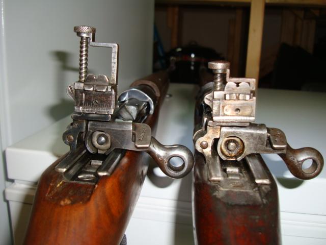

    Good morning:
    I just acquired a 1915 dated Mk III. It has an issue stamp which I can't identify. It's a RCC/CEF/466 Does anyone know what RCC is for? I have Barry Manarey's old handbook of identification marks on Canadian arms, but its list is incomplete, and there was also some variation in how things were stamped. CC would be Cadet Corps or sometimes Chausseurs Canadiens, RRC could be Royal Regiment of Canadaicon, but RCC?
    Also, I'm not sure when we went from the line stamping style to the little CEF in circle stamping, or were those stamping styles used concurrently? A lot of the 1914 dated Rosses; (HMS Canada being the commonest seen of those now) have the circular issue stamps.
    Anyone know offhand?
    Looking at the rifle more in depth (I just received it) I also notice that it has a rather unusual rearsight. On a very cursory glance it is a standard sight, but in fact it is a smaller version of the regular sight. I have a similar one, but not identical, on one of my target Mk II**'s. Has anyone seen one of these mounted on a Mk III before? I'm wondering if I should change it to a more standard one, or leave it as is. Since it's a highly unusual sight (I haven't seen more than two myself) I'm assuming it must have been put on deliberately close to the time of the rifle's service life. If the rifle was one which was more recently "resurrected" from sporter status, it doesn't seem likely that someone would have a rare sight to put back on it instead of a standard one.........
    I also posted this on the Rossrifle.com forum, so if I get an answer there will post it here for interest sake.
    Thanks.
    Ed

    While I'm of no use to answer either the RCC or sight question, let me congratulate you on a great acquisition. I wish my Mk III was martially-marked. I'll check in over at rossrifle.com too, but look forward to you hopefully getting the answers.

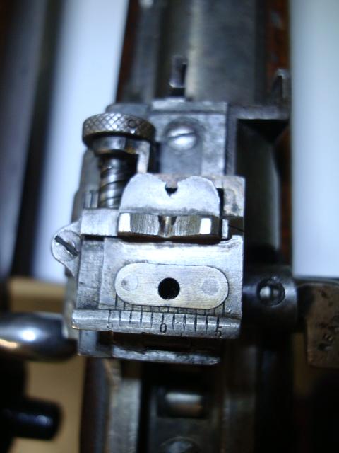

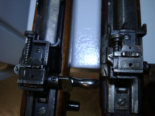

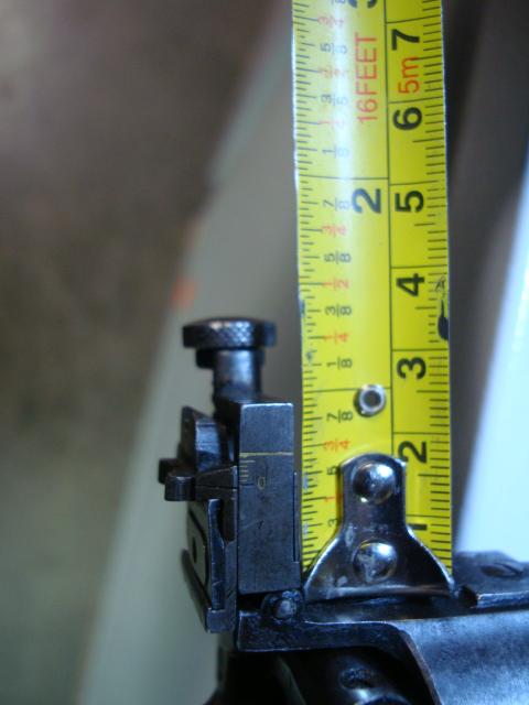

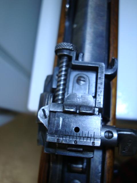

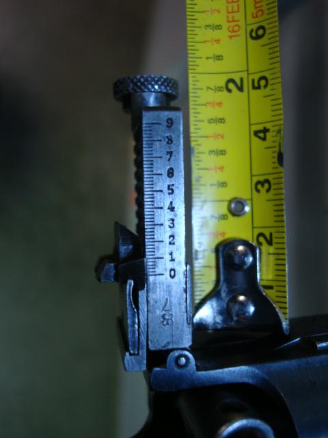

    Some more photos
    I've included a few more photos side-side with an original. There are no elevation gradations. *The sight has many parts of an original sight, but is shorter, with no proofs, and the elevation screw is pinned in a different way. *I think it must be a commercial variation version of the original; if it was a modified original one, cut down, say, it would have the elevation graduations on the side still, but there's no evidence of them having been there. *Instead, there is a single index mark. *There is no maker's mark either. *Don't really know what to make of it. *My inclination is to pull it off the rifle and put one of my spare original issue ones on. *
    Cheers
    Ed

    Looks like it was cut off and brazed together from the line on the side.
