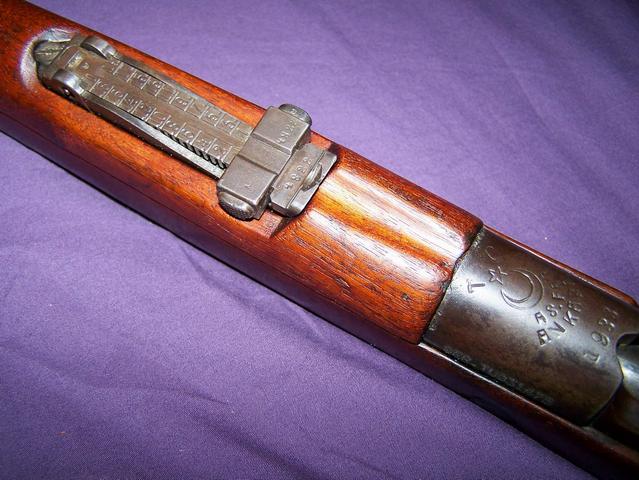

    This wood was totally stripped and bleached to the color of driftwood, then recolored with Buckskin (yellow) and Britishicon Tan (red). Final finish of Tung Oil Finish and BLOicon mix. Best wishes. Dave
