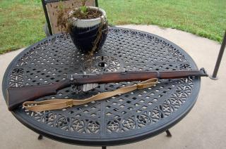

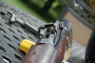

    Greetings all!
    I am in need of some advice on my Ishapore No.1 Mk.3* 1948 GRI. I have had the rifle for a while now and it needed an extractor spring which has now been replaced. Yesterday a buddy and I went out to shoot it. All went well with one exception. When the gun fired the bolt handle moved to be horizontal. All that was needed to open the action was to pull the bolt handle rearward! I have searched several forums and did not come up with this issue. I suspect this is not normal ... it seem a bit dangerous to me.
    Any ideas what to do?

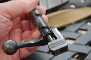

    Have heard of a couple of cases previously that turned out to be the mainspring. The ends of the spring are in contact with the rear of the collar on the striker at the front, and with the inside of the rear surface of the bolt body at the back. When cocking the bolt, the cocking piece (and therefore the striker) is held at the rear by the sear and do not rotate. The bolt body is moved forward compressing the spring until the bolt is up against the rear of the barrel, then rotated to the right 60deg to lock.
    If there are burrs on the ends of the coils in the mainspring, they can over time dig little groves in the surfaces they run on. With the spring compressed when closing a cocked bolt, the rear can rotated with the bolt body if it grips. If the front of the mainspring grips the rear surface of the striker collar, then the coil spring is torqued. It's not enough to stop the bolt handle from being locked down under spring weight against the locking lugs, but when fired, the bolt body can be opened by the spring uncoiling.
    Hope the description is clear enough....
    Here's a pic of the bits concerned
    Attachment 45847
    of course there is always the possibility that the locking lugs are worn/ damaged, or have been re shaped by some well meaning bubba

    Quote Originally Posted by Son View Post
    Attachment 45847
    This makes sense to me and is certainly something that I would have never thought of in this lifetime. I just ordered a bolt take-down tool from SARCO Inc. Hopefully, it will be here next week sometime and I can get the bolt apart.

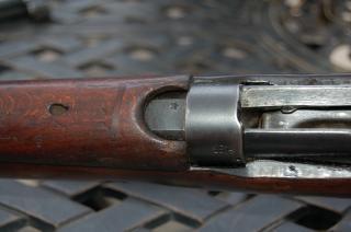

    I just took a closer look at the rifle and there is something that I failed to notice before. With the bolt handle down the long locking lug does not contact the right receiver/bolthead track. I am guessing here, but, I would think a .015" feeler gauge would fit between them.
    Additionally, the bolt handle does hit the stock socket. In fact, there is a slight groove worn into it from the bolt handle. It is deep enough to catch it with a finger nail.
    So, given this post, is it correct that the bolt handle should not hit the socket and the long locking lug should contact the right receiver/bolthead track? If so, what is the proper repair? Bend the bold? Grind a little off the bolt? Grind a little off the socket? Weld everything together and make it a single shot? ooops! I am getting rediculous now.

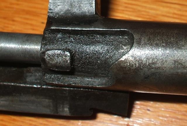

    I just checked and the striker cam is intact. The bolt handle does indeed contact the butt socket when the bolt is down and a slight groove has been worn into the socket.
