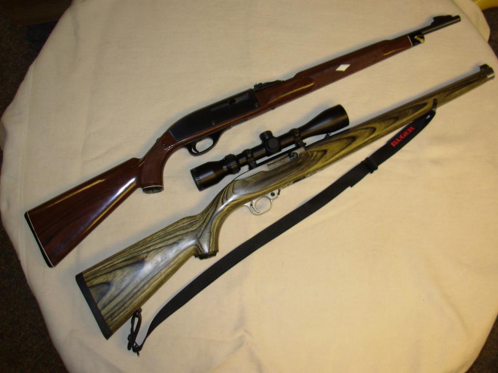

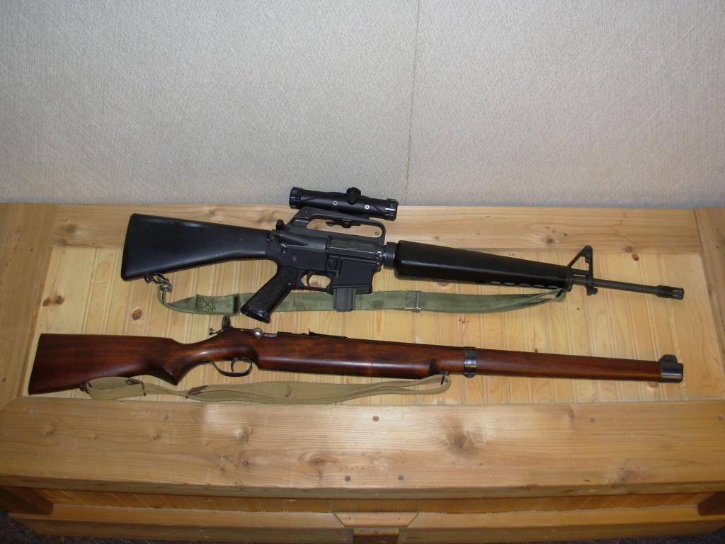

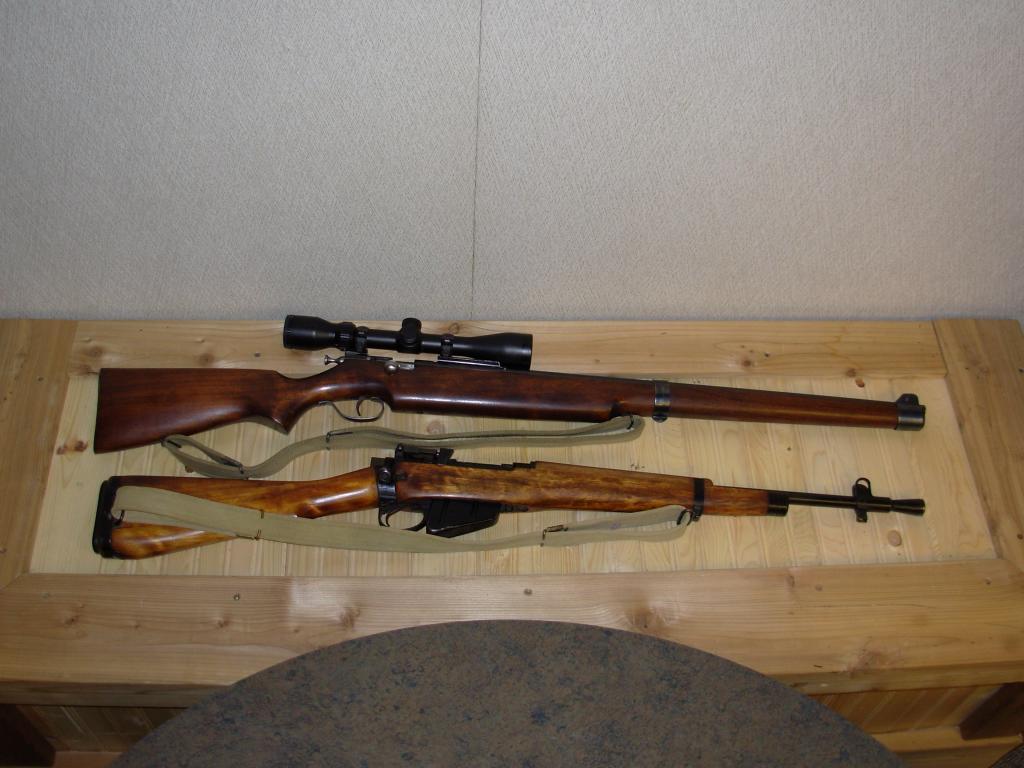

    hey - im still around , just been a rocky last few months - lost my job of near 30 years and have been trying to put things back in order , ive had issues in the past with photobucket but am rebuilding that mess , ill use this post to test my results ,
    the cooey M82 mount was set up by buying a section of rail and modifying it to fit b, i utilized the screw mounts of the existing sights and dovetail , ive since reverted it back to original condition and cannot take new [hotos , but here is what i have ,

    it held great , very rigid once the scope was locked in , we are talking a 22cal here so recoil was never an issue , i tried the single rail but i felt it blocked the chamber too much , if it were magazine fed in lieu of the single loader might be OK , as you can see the cockingpiece is hard to reach as well ,
    my wife has that scope on her 10/22 , not sayin it caused me to disassemble this setup , im .....just sayin .....she has the scope now
