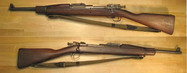

    During 1942 the 158th Infantry of the Oklahoma National Guard were stationed in the Canal Zone of Panama with this carbine style of 03. The mods were done by the ordnance shops in Panama, & did not have Parkerizing capability, so all the barrels were blued after being cut down to 18 inches. (Reference was from 'The Springfield 1903 Rifles' by Lt. Col. William S Brophy)
    Does anyone know how many of these rifles were produced? Other than the obvious barrel and forward stock modifications, were there any other alterations done to this rifle. The book entitled 'Springfield Armory/Shoulder Weapons 1795-1968' by Robert Ball have some great pics of this rifle as well, but not much info. Any info would be appreciated. Here's a pic of a copy I found on the net:

    Brophy is the source of most of the info out there, but he doesn't say how many were altered. We can't even determine a figure from the strength of the regiment, since there seem to be no evidence of what percentage of its troops were issued the shortened rifle.
    Supposedly, they were all called in and converted back to standard rifles. Since the military generally did not miss many on a recall like that, and since a counterfeit would be easy to make, any "Bushmaster" for sale at a premium price should have solid documentation of its provenance.
    FWIW, some folks feel that issue of those rifles means that there was a carbine version of the Model 1903, as there was with the trapdoor and Kragicon. But others (including the present poster) feel those were locally made and in no way a formally adopted "Model 1903 carbine."

    said rifle was used in Combat, and givin its own model, you can find serveral combat pictures of this rifle, one is in the National rifleman in 1943 shows a troop aiming it in the brush.
    stock used on the ones iv seen pictures of were grasping grooves, and the rifles had not sight covers. with a taller front sight.
    there is a nother 1903 carbine. that never made production, i have a few pictures someplace, the sling swivle is set in the side of the stock, and the front swivle is also modified for the side, 18" barrel, with special sights.
    the one o saw a picture of, had a brass plack on the side discribing it as 1903C carbine. experimantal trials rifle. or something to the effect, the RIA museum has a version of this rifle as well on display.

    I didn't realize that their was an experimental model as well. Any pics?

    You know, it didn't even click in the first time I read your post. Of course the front sight would have to be higher to properly regulate the rear sight elevation. I guess it pays to re read posts.

    I do agree that any of these rifles sold as original had better come with documentation from a creditable source, as so with a lot of the variants of the 03, as their were a lot of copies made & past off as originals. A very healthy dose of skepticism should be used when purchasing any of these types of rifles. I don't believe this rifle could be called a variant of the 03 as well, as it was only modified & issued for the one purpose to the 158th. None the less, it would be nice to have at least a copy of this rifle if the 'spare parts' are found to assembly such a rifle.

    i have a pic someplace, might take me a while, search the Cody museum, i think they have it on display,
    as far as i know, all the busmaster carbines were destroyed, might be a couple floating around, but without a letter from Restone Ars, id say no.

    There were a few experimental 1903-based rifles made up at Springfield from time to time, and ten times that number that Springfield never saw. Every chopped up, bubbaized, hacksaw job at a gun show is either an experimental (usually a "super secret" one), an "air service rifle", or one of the "rare Bushmasters."
    There are several pictures of the "Bushmaster", and Brophy shows three of them. I have never seen any credible evidence that they were used in combat, though some realistic "combat" pictures were taken during exercises in Panama. There are reports of one being used in Europe, but the evidence is slender.
