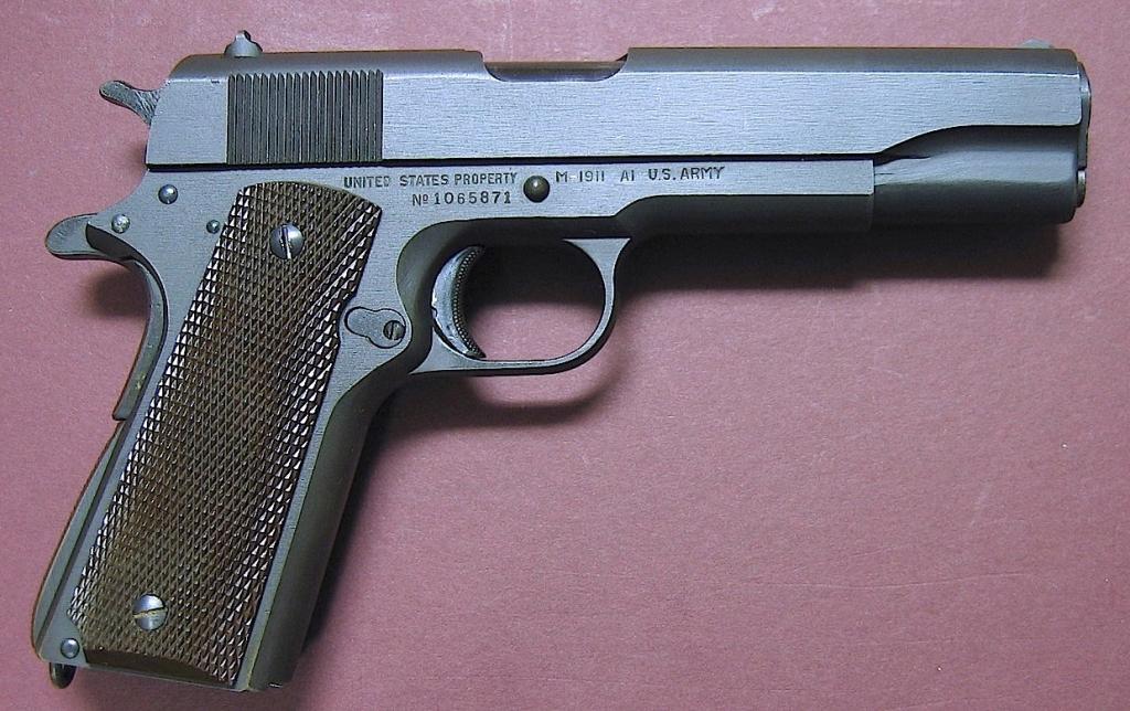

    Slide and receiver have been refinished in phosphate. Original finish would be Du-Lite blue over a lightly sandblasted finish. Original finish would look like this one.

    Wow, that's a nice looking gun Johnny. I didn't know all US&S pistols were originally blued. Most pictures that I've seen are parked.

    Most of the early information on the US&S indicated the finish was phosphate until Charles Clawson brought out his book in 1991 describing the Du-Lite blue finish. The blue was applied over a sandblasted finish, and it does have the appearance of phosphate (Parkerized) finish except for the blue/gray color. The early Remington Rand and Ithaca pistols were also finished in Du-Lite, but changed to phosphate. US&S ended production before switching to phosphate.
