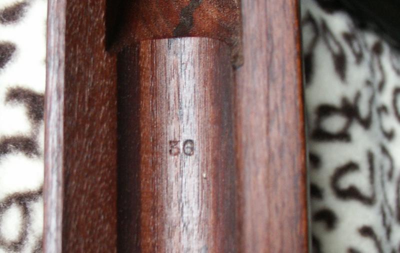

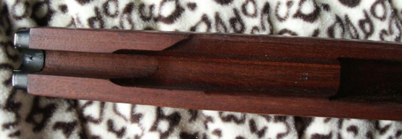

    I have a 10/41 SA with a long channel stock, it has the number "36" stamped near the center of the barrel channel. Anyone know what these mean, if anything other than a inspection mark?

    Is that EVER nice wood! That's about the cleanest I've ever seen and at that age...the markings aren't what I'd expect to see but the number range is. Mine's a bit earlier. About 60,000 earlier...I think the number is just an inspector's number, mine is a simple "4". If it's not too much trouble, we'd love to see the whole rifle...all the small parts...as for the suncorite, if it really is, there'll be a couple along that may have a positive answer as to what or why.

    Your stock had a SA over GHS cartouche. The number/numbers and letter started with the early no trap SA SPG stocks

    Yep just inspection marks. Yours is so close to the one I had for years but sold. Rick Bicon

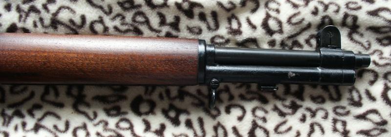

    I've been able to trace the rifle back four owners, the last to I know, then it was in a shop owner I know, he got it at an estate purchase. He's going to check his records and see if he can find the name. It's my belief that who ever bought this back in the late 50's to early 60's is responsible for sanding the exterior wood and possible the Suncorite like paint. Most photos I see of the LL's they have the SA/GHS cartouche intact. Who knows what was done to it in Englandicon.
    I need to do a complete tear down and clean, I'll get better pic's when I do. I'm a novice Garandicon owner, I have one other with a Krieger NM barrel, NM op-rod, new wood, from garandguy back in PA. Hardly a gi rifle. I've checked all drawing numbers against the Duff info on LL rifles and it sure looks authentic to me.

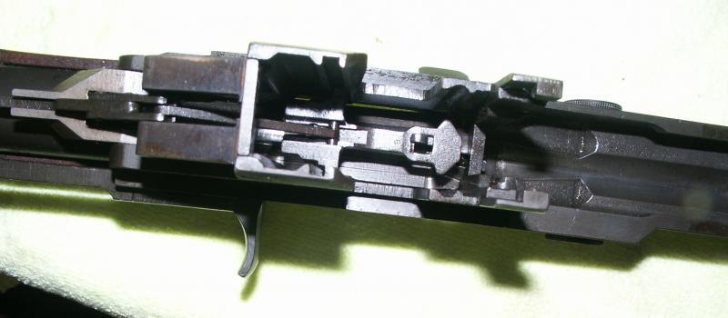

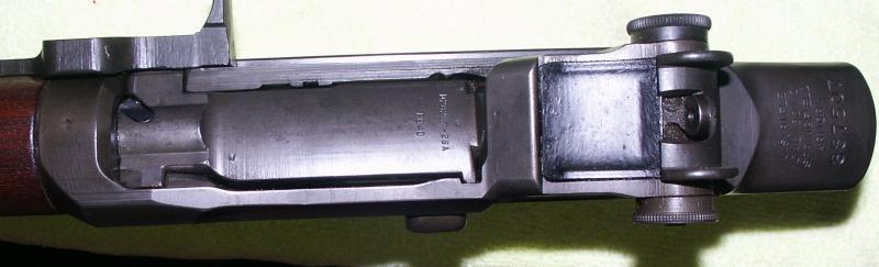

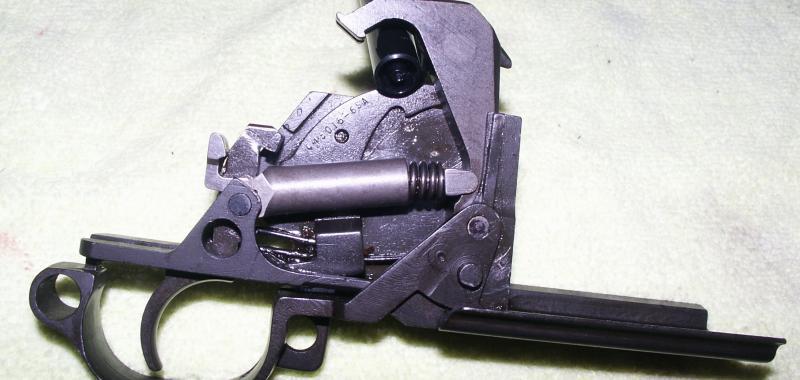

    Here's a couple of quick shots.

    madcratebuilder,
    I see that your stock has the long throat and also has the dimple in the stock ferrule, both of which are correct for your serial number.
    I have 312671 with the same stock with 36 in the barrel channel.
    My 529595 and 540736 both have 36 in the barrel channel and both have the short throat stock with the large hole in the stock ferrule.
    I have 387625 with the long throat and dimple with 15 in the channel.
    I also expected to see the -2SA RE4D bolt and the follower with the 8 in the middle, which you have.

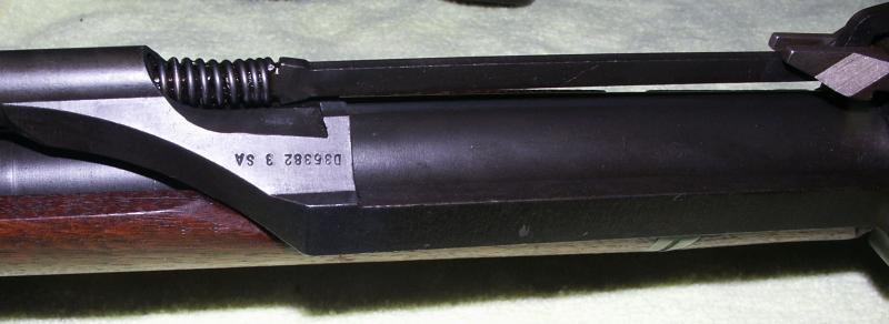

    What is the revision number on your trigger guard? My 387625 has the C-46025-3-SA.

    Ed, I have a revision 3 trigger guard on my Lend lease 380931 rifle
