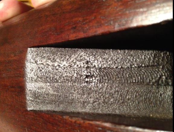

    I had very little time to inspect the gun.These were some pictures I was able to take.
    Any recognise these markings in the sling well?

    Quote Originally Posted by Burtonaxe View Post
    Slingwell markings and milling style look like M-U
    Marlin made for Underwood.
    Most all I've seen are stamped right side up, with the buttplate on the table.
    HTH,
    Charlie-Painter777
