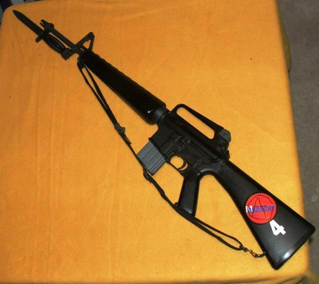

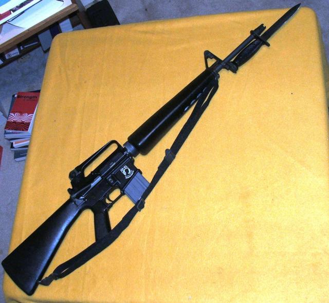

    My AR-15a (one & a half)

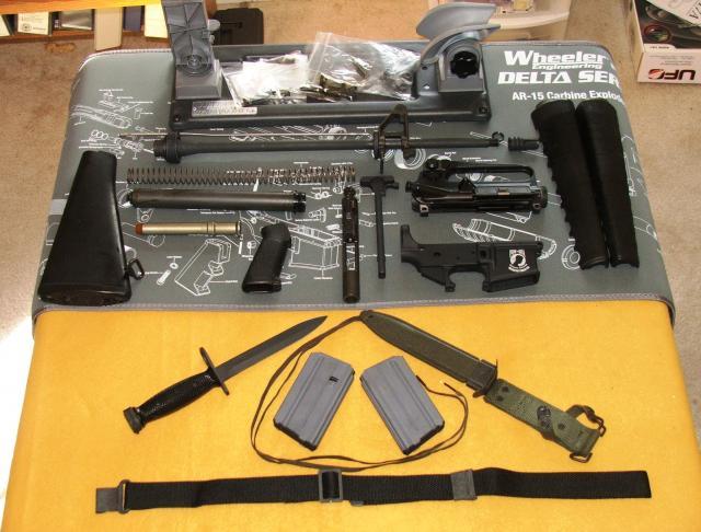

    Is this sacrilegious? I just finished my FIRST AR build. I was going to buy one pre-built close to the way I wanted it. In fact I ordered and pre-paid for it, with the knowledge of suspected 90 day build time. Guess what? 90 days later company is OUT of BUSINESS! No GUN! I’m P!$$ED! Fortunately my credit card company refunded my payment, so I decided to build my own.
    Colt; “CM” A2 upper receiver w/ sights, forward assist, and charge handle. (got this and $150 as payment for a SKS I was getting rid of)
    RGuns; Stripped lower w/POW-MIA logo etched on mag-well.
    McKay; M16A1 parts kit. (over paid, only missing a couple pins/springs, and 2 chipped teeth in hand guard)
    McKay; 20” chrome lined, pencil profile, 1in7 twist barrel. (waiting on gunsmith to install FSB on new barrel, align and drill for taper pins)
    PK Firearms; 3prong flash hider w/ crush washer, and a couple 20 round magazines.
    Numrich; Colt M7 bayonet w/scabbard, complete triangle hand guard set, replacement butt pad, sling.
    Midway USAicon; BSA 4x20 Duplex Reticle handle mount scope. (I’m old and need help seeing 100 yards sometimes) various tools supplies etc…
    Let me know if I went overboard. I can’t wait to get this to the range and see how it shoots.

    I guess it all depends on how much you have wrapped up in it whether you went overboard or not. It's a nice looking rifle however with the E2 rear sight the Pepto Bismal hand guards, flat delta ring and three prong flash hider are rather out of place. Get her to the range and report back to us.
