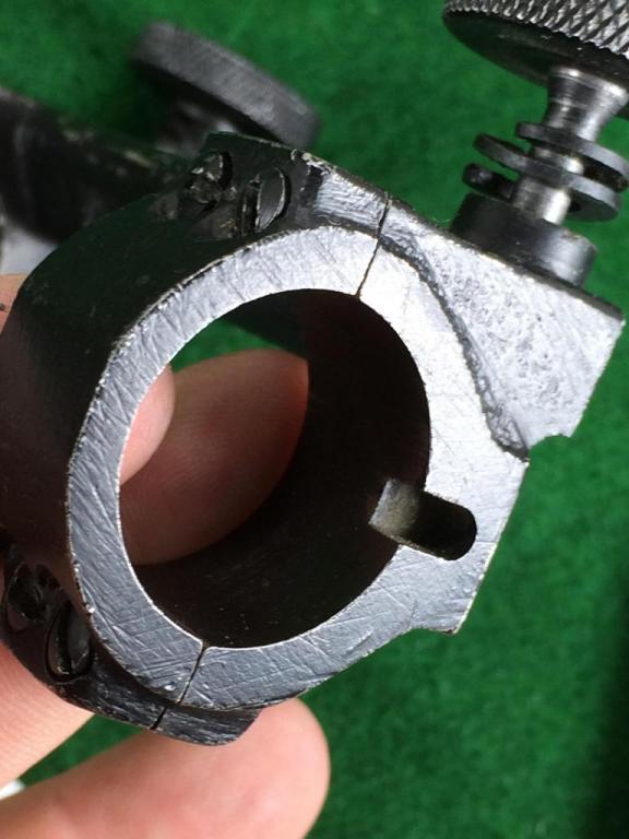

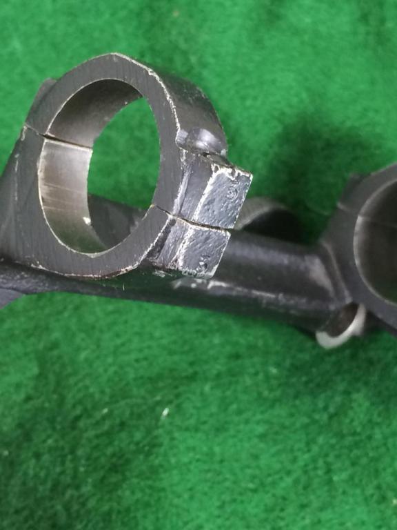

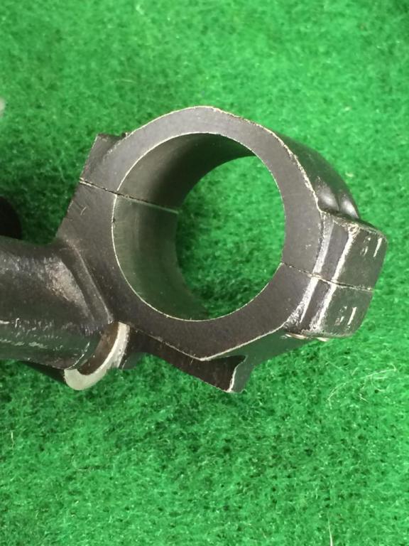

    Enfield Mk No4 Mk1 Scope Bridge for review
    This item is out of my area of knowledge...it is listed on ebay. The pics aren't the greatest, so I've posted some others below. I have elevated the price until I get an accurate assessment of condition and valuation. Here's a link: (if this isn't permitted in the forum, please feel free to adjust)
    Vintage Enfield Sniper Scope Mount No 4 British Enfield No4 MK1 Genuine | eBay
    I was told to bring it over here for your evaluation. I've received several "expert" opinions, some say it's a fake other have said it's real, some feel it's been modified and others not.
    Here are some pics, most focus on the smaller ring...I can post other specific pics if so desired. Thanks for your input in advance...

    Looks "real" enough, but it's seriously messed up! Very sad.

    The answer is very simple and needs no further elaboration. It looks real/genuine enough but in the past, probably when these things were dirt cheap and ten-a-penny, some turkey has fitted another telescope to it and found that he needs to cut the rearmost 1/2" or so off the rear end in order to allow the ocular end of his 'better' telescope to to fit.
    The good news is that you could still use it with a No32 telescope and it'd still hold the telescope fast because the horizontal movement of the telescope is controlled by the front cradle part, as is the anti rotation medium. And the front cradle part is intact.
    The same turkey that 'fixed' your bracket came to my house recently to 'fix' my leaky shower tiles. He's been back a few times since to 're-fix' the leaks but he's failed because they don't make that silicon sealer stuff in half hundredweight tubes

    It should be against the law for some people to posses a hacksaw....
    What are the chances of the leg breaking off under recoil? The ''turkey'' didn't leave much of a radius in the corner. Looks like he just snapped off the portion to be removed after making the cuts.

    It would only be worth anything to me if I had the rifle of that serial number. At that point I dont know whether I'd silver solder the steel back and re-machine it as it was or leave it.
    (edit) wow it went for $230USD!
