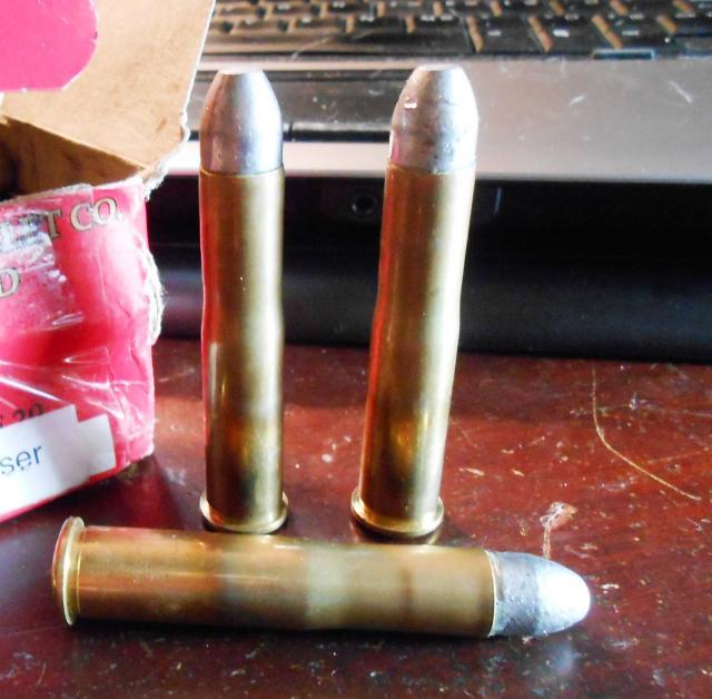

    Have 20 rounds of new black powder cartridges on the way from WI.
    T

    Range report. Scattered showers, 72 degrees. 100 yards, seated, no sling, reloaded 11mm with black powder. 10 rounds (at $4 each). Took a few shots to figure out the Kentucky elevation, settled at 4:00 and a little low. Not too bad for a first time. Awkward to remove the spent case; the bolt has an extractor, not an ejector. A hoot to shoot.

    Good to see the old smoke-pole banging again. Unless you want to spend a fortune on ammo, you are just going to have to get into BPCR reloading. You now have some fire-formed cases, and IF you can get the right size bullets, you will not have to do any more resizing than just neck-sizing. In fact, if you are lucky in the bullet/chamber combination, you may be able to get away with NO-sizing - which is what I do.
    Get hold of a soft lead .45 round ball and drive it through the well-lubricate bore from the breech end. A yard or meter length of 3/8" or 9mm brass rod will make short work of that. Measure the ball to see what you need as a maximum bullet diameter. The answer will probably be around 0.446", and the next thing is to measure the inside diameter of the neck on a fired cartridge. Since lead bullets will obturate to fit the bore, you have some leeway in bullet size. If you can get a mold that casts a bullet that is a finger/thumb push-fit in the neck, that is pretty much ideal. And your cases will last for a very long time indeed!
    Bullet size as-cast and obturation is also dependent on the lead-tin alloy. Something in the range 3-5 % of tin will do. Avoid wheel-weights, whatever the penny-pinchers may tell you. Use pure lead. Roofer's lead flashing is pure enough. A bit of experimentation is unavoidable, but worth it. With ammo matched to your rifle, and off a rest at 100, you should be able to get all shots in the black more or less immediately, and all in the 8 ring with a bit of practice.
    Re. Kentucky elevation. Use the 6 o'clock aim, and practise holding the foresight really deep in the V. This will provide a better horizontal centering than the often propagated top-of-V-and-foresight "in-line" method. And is the only accurate way to bring the POI down at 100, unless you want to start carving up the backsight leaf (DON'T), which would be an irreversible alteration to an antique..
