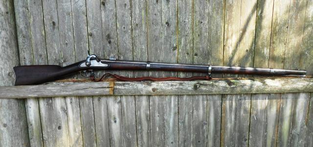

    I've wanted one of these since I was in middle school, 30-odd years ago. Seeing my friend's in TN on our recent road trip got me looking again for a decently priced example.
    Picked this up on Gunbroker and then picked it up on the way home in Ohio. Cost between a reproduction Armi-Sport and Pedersoli M61. Why buy repro when you can buy original for the same money? Markings on the breech (1861) and (V/P/Eagle) are faint and visible only in just the right light. Middle band is original, but the rounded, smaller M63 variety. I've a line on trading up to the right M61 flat style one. The nipple is a replacement and the rear sight is held on by a modern hex-top screw. I bought an original for it, but the screw hold had been re-sleeved and the threads aren't wide enough. Need to work on the right side rust a little. This was carried by a re-enactor for several years. Plenty of rifling.
    Of course I'm going to shoot it.

    The rust came right off with Kroil and a ScotchBrite pad. I also repaired the nose cap; the retaining hole in the wood had lost its top end leaving a long groove for the screw and nose to slide off. I bent a soft piece of metal with a screw hole into a "U" and reamed the wood hole into an oval to allow the "U" to fit and screw tight and securely into the nose cap.

    Nice musket and a rare date!

    the bore looks great!
