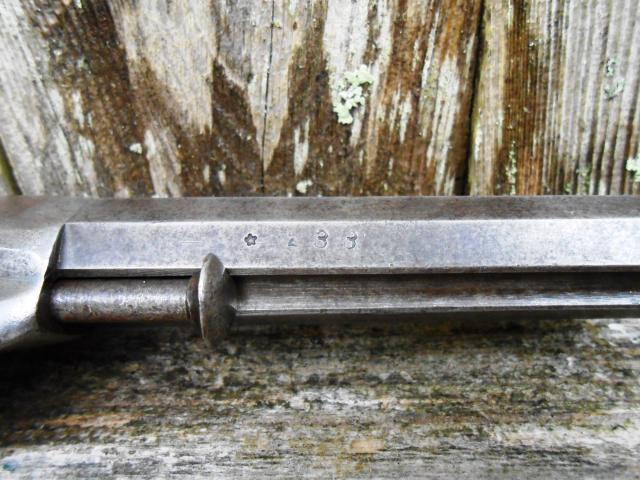

    With the serial number of *233, the pistol is a very early one, probably produced in first year run of 1857. *233 is visible on the trigger guard, barrel, cylinder, and frame. Finish is about 25% blue and patina. Cylinder works fine and the bore is great for its age. Markings are clear save the "Allen and Wheelock Worcester, MA" which appears as a faint solid line. I had to open one cylinder by drilling through from the face and using a nail to punch out the rust blockage. A little difficult as the nipples are not removable and sit at right angles to the chamber. Scale is shown with an 1858 half dollar.
