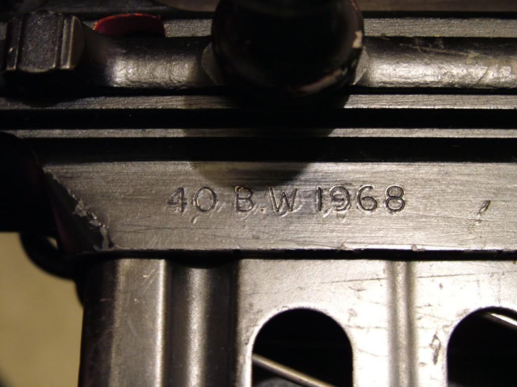

    Thanks for the info Peter, this is a nice illustration of the MG5526 number on a L4A3.Attachment 55535 Attachment 55534Attachment 55531 Attachment 55532Attachment 55533

    That's the one........ Now, according to the practice, that body should now be modified to read L4A3 With 3 barred through and 5 engraved alongside. MG 37 GA barred out and re engraved MG43 GA re-engraved.
    But according to the theory we reverse the order of natural selection and progression and ............... But bear in mind that these were in Navy service (having already been approved for use by the MoD) and if they fitted a later barrel, the nicities of EMER's and BR's weren't uppermost in their minds.
    Because Enfield held the IPR to this 7.62mm conversion process and wouldn't allow it to be carried out elsewhere, in order to keep the workforce at Enfield fully and gainfully employed, some nations, especially Africa - Ghana being a large player - who took advantage of a costed Military Aid or Crown Agents programme just sent the gun bodies to be converted. They - Ghana and Sierra Leone being a prime examples - sent over, say, 500 heaps of pure shot-out, worn out sxxxe Mk2 bodies and got back 500 virtually new FTR'd 7.62 Mk2 bodies, single 5526 barrels and 5000 magazines. Courtesy of you, the taxpayer!
    Under the Crown Agents Programmes (the CAP's), certainly in my limited Simgapore 40 Base Workshop experience, if the nations sent in 500 of something and 100 were crap, as were hundreds of their No4's, 5's and Brens, then they would still get the same quantity back, made up from UKicon stockpiles.

    Peter, were you at 40 Base Workshops in 1968?

    Yep, that's one of ours. We still had hundreds of FN's floating around and some of those were used by the trade test courses to do just this sort of thing. John Dudley (QLD), Dave Lee (Ipswich) and Lauri Taggart Castlemaine) other RAEMEArmourers at 8 RAR from QLD/ was doing these as part of their 1st Class and advanced machine shop phase. They also did some of the captured VC early AK47's and GBF's* too
