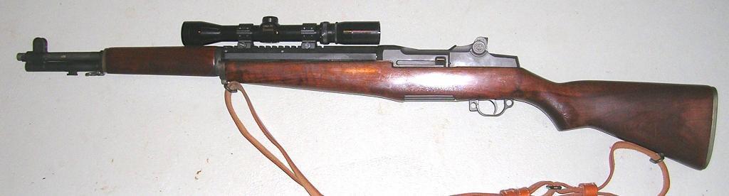

    Looks like this
    except my scope is a tad lower. It just works great with a stock set up for irons.
    M1 Garand Scout Scope Mount
    Been too busy playing with my SMLE, Swede 96 and Bushmaster 450 to dig it out for pics.
    If you have a commercial account with Brownells you can get it cheaper.

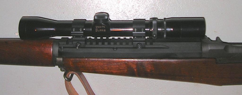

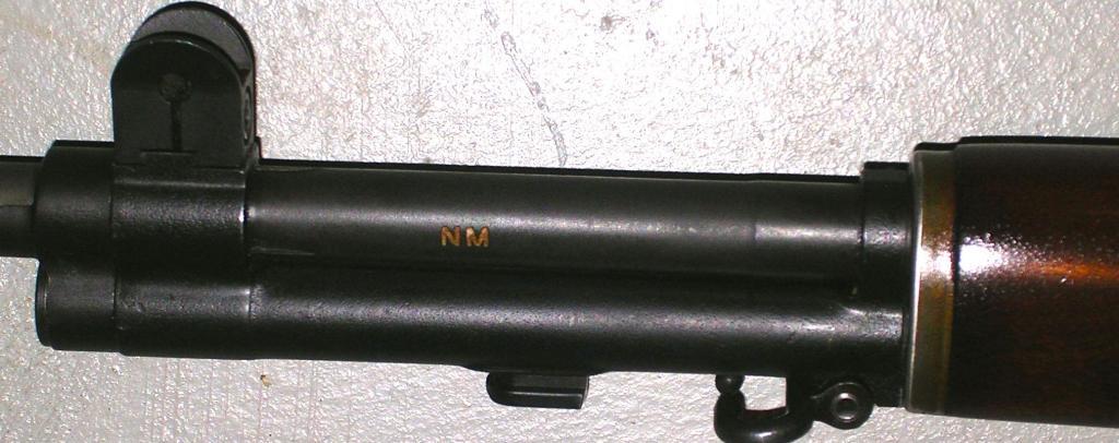

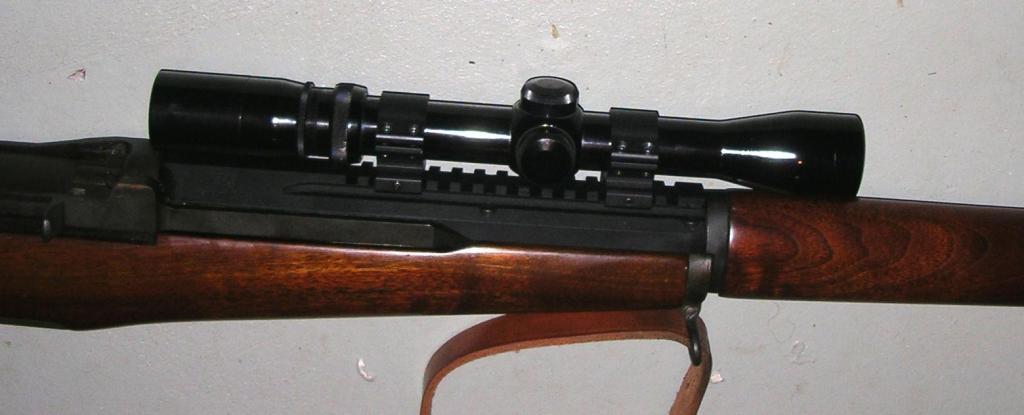

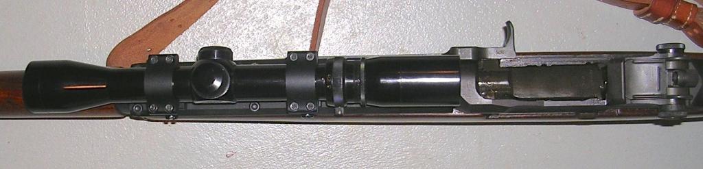

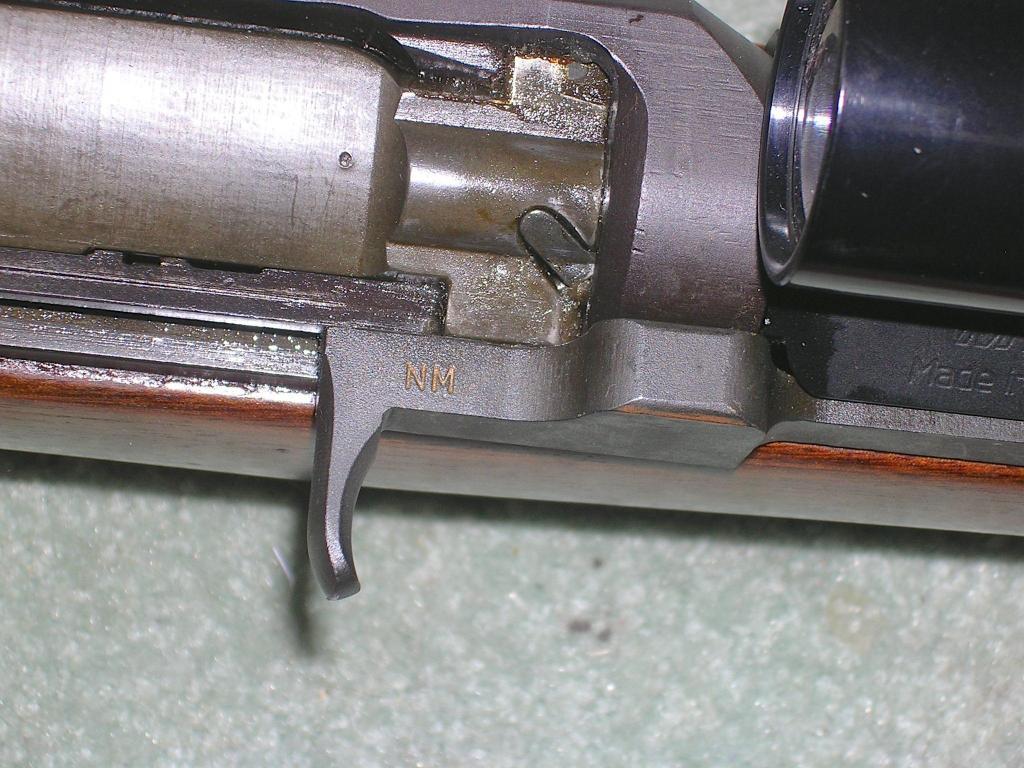

    It's rock solid. When you shoot 8 full power GI loads off a bench rest, anything that will move does. IF your rifle in a National Match (like mine) you must be sure to pin the front hand guard (as all battle rifles were). The hole is there, you just need to make a pin.
    Of those 8 shots the last 3 @100 went in 3/4". The first 5 were spent testing and getting on the paper @25.
    In the photos you can see the big allen screws that secure the fitted clamps around the barrel. Nothing is going anywhere. The objective lens does clear the hand guard by just enough as does the ocular the receiver. If the rear peep intruding a bit in you FOV bothers you, you could get higher mounts or remove it. I like the tight cheek weld as I have it. If you have ever shot an M-1 C or D, you will be transported to OZ.
    Hers are pics of mine:
