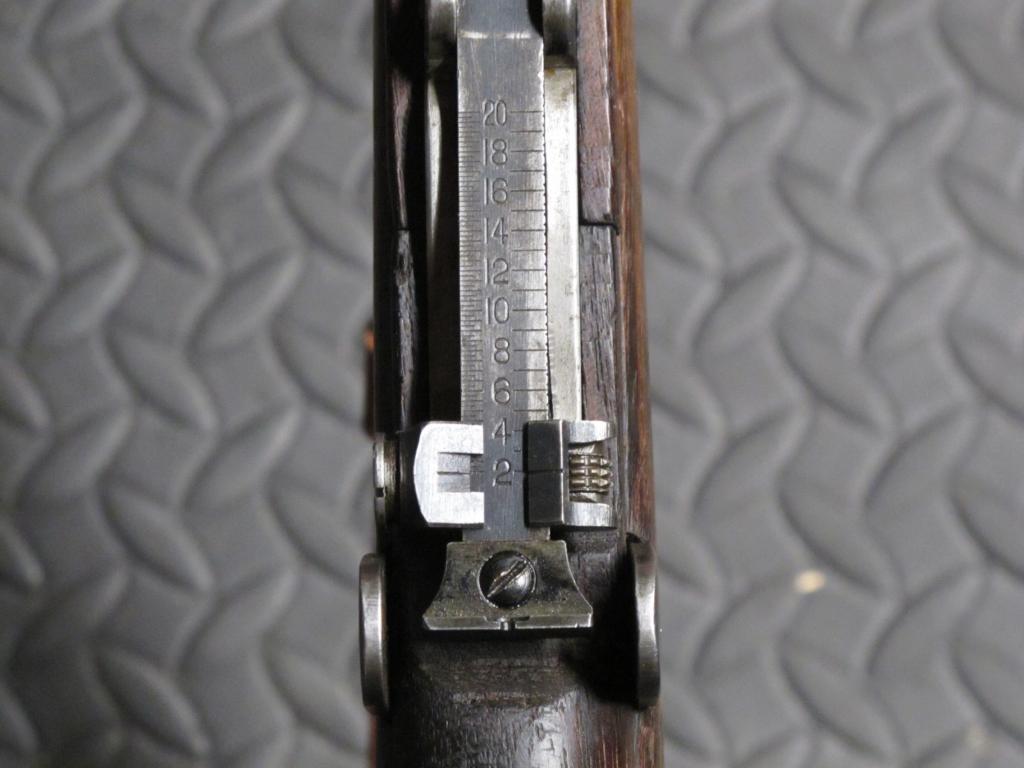

    Here are some photos of when I bought the 2A this summer. Sorry, I don't have an account with an on line hosting site to post better photos.
    You really can see the gap between the long locking lug and the receiver. The bolt handle is right against the receiver when closed. IF you lift the handle you can see a wear spot on both parts right down to the white.
