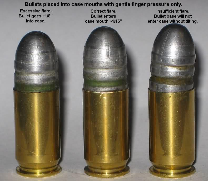

    I suspect you just need to bell them a bit more. Hard to say without seeing it. Try a bit greater bell.

    A picture is worth a thousand words.
    Top illustration, Parashooter.
    For a couple of reasons, excessive "belling" is a bad idea.
    1. It over-works the brass and the stuff splits WAY before its time.
    2. Too big a "bell" makes it hard to shove the case into the seating die.
    A little "experimentation" before going mad with a big batch will save a LOT of unseemly language.

    Thanks all, excellent advice. I increased the belling slightly. The cast bullets now seat initially about 1/16" in the mouth. Lead shaving is completely eliminated.
