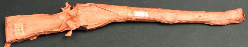

    The auction catalouge states it is Irish contract, yet the records I have say a Mk2 should be a PF or UF number and the Irish contract was "PF 309348 to PF 359347 Irish Republic (50,000 rifles)". In terms of checking it out it is why I asked here as I have seen several Axxxxx mk2's in NZicon but I dont know where they came from, I'd like to know. I have also seen several other claims of WW2 LB rifles etc "still in their wrap", "still in grease" etc which I was and am dubious about. Rifles of all sorts being sold "in the wrap"s is getting a bit frequent to my mind and of course cannot be easily checked.

    Here's the rifle, the wrapping still has its original Fazakerley labels. Like I said the 'Irish Contract' is probably what the seller stated it was. Regardless, you won't get a better New/'unissued' No. 4 Rifle. I think it will end up going to Australiaicon.
