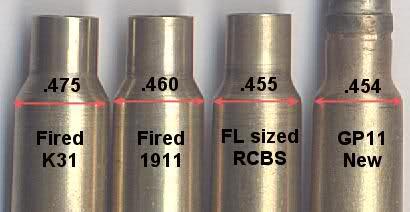

    Any decent 7.5x55 sizing die will work just fine for the K31icon. The idea that only the Hornady or Redding die is correct for the K31 chamber has been way overdone at some sites. In practice, the most often cited benefit of the wide-shouldered "K31" die is very slight - for the simple reason that it works the neck no more or less than a 1911-style die and it's the neck that fails first from work-hardening, not the shoulder. Proper annealing takes care of both neck and shoulder - and has to be done for the neck anyway, long before the shoulder actually needs it.
    Those who argue that the "K31" die necessarily gives greater accuracy fail to recognize that a carefully FL-sized cartridge is centered by the cone of the case shoulder mating with the cone of the chamber shoulder. This occurs whether the major shoulder diameter is .455" from a 1911-type die or .472" from a "K31" die.
    A few handloaders claim that the "K31" die, by doing less work, requires less force on the press handle. That's undoubtedly true - but if you use the right lube, sizing a K31-fired case in a 1911 die isn't difficult anyway. Of course some handloaders are addicted to pretty ineffective case lubes and aren't eager to change to one that works better and costs less (e.g. castor oil).
    The only practical difference is that cases fired in a K31 normally elongate more during FL sizing in a 1911-type die than in the "K31" die. Brass displaced when shoulder diameter is reduced goes in the only direction open to it during sizing - forward. Consequently, less frequent trimming is required with the die that reduces the shoulder less. Many careful handloaders trim often simply for greater uniformity. Those who find trimming especially onerous are probably better off with the larger "K31" sizer.

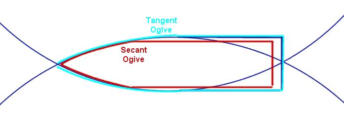

    Just be aware that the K-31 (and the ZfK-55) have SHORT throats that are meant to accommodate the GP-11 bullet with its SECANT ogive.
    Any suitably-weighted bullet with a TANGENT ogive, like the Sierra Match-King series, will probably give you problems with seating / overall length measurements. A K-31-owning friend found this out the hard way after he loaded up a batch of ammo with 168gn Sierra MatchKings and the found they would not chamber. They fed fine through K-11s, both his and mine.

    There is a significant difference in taper and consequent diameter at the body/shoulder junction -
    FWIW, the GP11 bullet features a tangent ogive, not secant. It's a long-radius ogive that begins pretty far back, but it's a tangent.

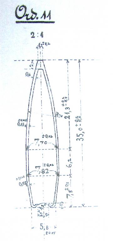

    By that diagram, there is NO parallel bearing surface anywhere on that bullet; there is a slight taper starting at the forward end of the boat-tail. This then changes to the 70mm ogive radius..
    So, the GP-11 bullet is not your "basic" bullet by a long shot. I don't have a CAD package on this computer yet, so, is anyone out there capable of whizzing up a quick (but accurate) profile from the sketch provided in order to ascertain exactly where that 70mm ogive radius runs?

    Quote Originally Posted by Bruce_in_Oz View Post
    . . . there is a slight taper starting at the forward end of the boat-tail. This then changes to the 70mm ogive radius.
    . . . is anyone out there capable of whizzing up a quick (but accurate) profile from the sketch provided in order to ascertain exactly where that 70mm ogive radius runs?
    That "sketch" is a vintage Swissicon mechanical drawing that accurately describes what we find when measuring GP11 bullets - "a slight taper starting at the forward end of the boat-tail" that "changes to the 70mm ogive radius" after some 6.2mm of a conical section 7.82mm diameter at its base and 7.70mm at the tangent ogive junction. While the design may be too unusual for some tastes, the Swiss seem to have been pleased enough to keep it in service for over 80 years - essentially unchanged except for playing around with cannelures.
    Attachment 62483
