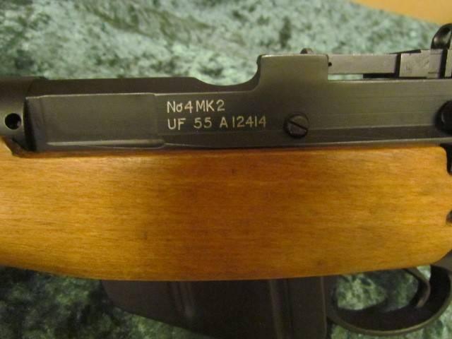

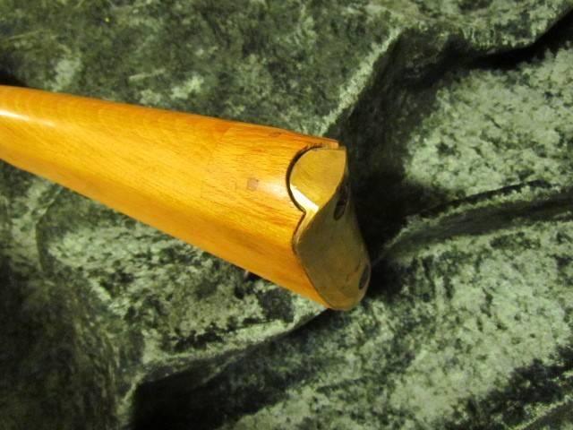

    The Proliferation of Enfileld Butt Repairs
    Can someone explain why the butts on our beloved Lee Enfields need so much patching? Clearly the butt plate, being incised lower than the stock caused the splits. Why didn't the top of the butt stock get shaved down to be flush with the butt plate? The only historic guns I own with this problem are my Lee Enfields; and, upon counting, 40% of my LE collection has had butt repairs.
    Do we just accept the idea that Brits like to do butt repair?
    Here's what prompted by inquiry. I was looking at a beautiful, pristine, unissued, 1955 UF series No.4 Mk2 (matching #s) on GunBroker LEE Enfield No4 MK2 UNISSUED .303 Britishicon UF 55 NR : Bolt Action Rifles at GunBroker.com
    . This gun had never had a moment of disreputable abuse. Here are two pics:
    Notice on this next one, the butt has been repaired (maybe by Captain Laidlericon's instructor, given the date it was probably done).
    Experts, what am I missing here? Should I believe that the boys at Fazakerley had a "butt fetish" and repaired gun butts before they needed repair? Or was this a "preemptive strike" knowing it was going to happen anyway? Or was this point forward of the butt plate so vulnerable that it chipped during fabrication? Or didn't they have enough butts around to use with apprentice Armourers for butt repair training? Why was the wood lip repaired and left exposed to chip again? Why wasn't a mod made to either the stock curvature (to fit the butt plate), or the butt plate size to fit the stock? To my eyes, the stock/butt plate interface was a design flaw that carried through all the way to the end of the line (UF series Mk2s).
    Please enlighten me -- what's left of my aging logical senses are stretched to the limit this morning ;-)

    Lee Enfield, your thread 2, re the odd markings. I have another Mk2 butt with the FT logo for Fredk. Tibbenham in Ipswich, Englandicon and that has the smaller unknown mark on it, as shown in your thread. This would indicate that this mark is not Canadian or a Canadian disposal mark. Unless, hghly unlikely, the butt went to Canadaicon and was disposed of on a Mk2 gun from there. Am, pretty positive about the interlocked CWD markj though.
    Fazakerley were geared up to heel and toe patch rifle butts being FTR'd so it makes sense to send a new butt through the process if it needed it - like the example shown. Waste not, want not. As for the second little split, I'm bound to ask how do you know that it wasn't done later? The butt plate must be fitted accurately to the butt where they meet at the end. The tang of the butt plate should be CLEAR of the butt by the width of a hacksaw blade - ish. This ensures that the tang won't split the butt - like yours - during firing and drill.
