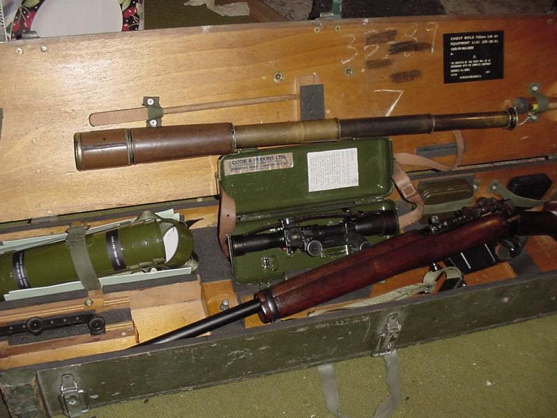

    Pic of my telescope case
    Greetings,
    I picked up mine about 7 or 8'ish years ago from a dealer in the UKicon. I believe I paid 80GBP at the time. It is constructed of high impact plastic, internally lined with plastic foam and keeps out the water well. Unfortunately, I haven't been able to find another one. To quote one our own, they appear to be as rare as "rocking horse poop" I liked to look of it but really don''t know if it would be appropriate for my CES chest. They may have been issued too late to have seen service alongside the L42A1's
    Best Regards,
    Michael

    You're dead right Flight RN. The plastic tube thinggy (see, more of those technical REME Officer-like terms again...) was a direct replacement issue for the L42 CES. Plenty were issued to complete the L42 CES but were taken from the kits prior to disposal. Apparently a big load were disosed of some 10 years ago when nobody really knew what they were................... I expect that there are a load of chippies (that's another quaint old English term for 'carpenters' .....no, not the singing duo!) using them to carry nails in!
