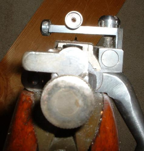

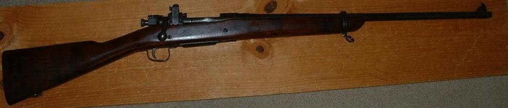

    Here are a couple of pictures...

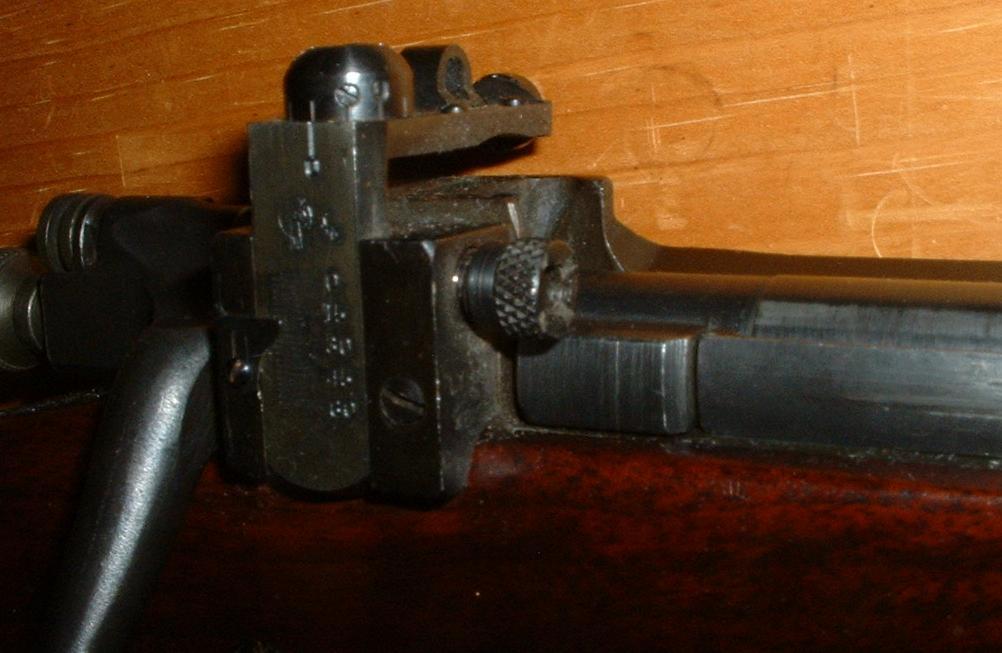

    A few weeks ago I posted about a SC 03A3 that I have and was planning on converting to a 03A4gery, but had found that the reverse dovetail had been ground off. Readers offered some suggestions for restoring the reverse dovetail, but I decided getting a recovered drill rifle receiver might make more sense.
    I was poking around on the auctions and found this instead. It arrived, along with a second rifle that I glommed, at my FFL today.
    Description advised:
    Smith Corona Model 03A3 .30-06 caliber, 24" barrel, S/N 36179xx, barrel dated SC 2-42. Original parkerized finish on the receiver and barrel. A new sporting stock added. Condition: Excellent.
    I gave the rifle a quick once-over before it went into my FFL's safe for the obligatory 10-day "cooling off" period. It looked like the barrel was dated 2-42, which is very early. It also looked like it might have 6 grooves. The bore and metal looked in great shape.
    Also, most importantly, it still has the reverse dovetail intact
