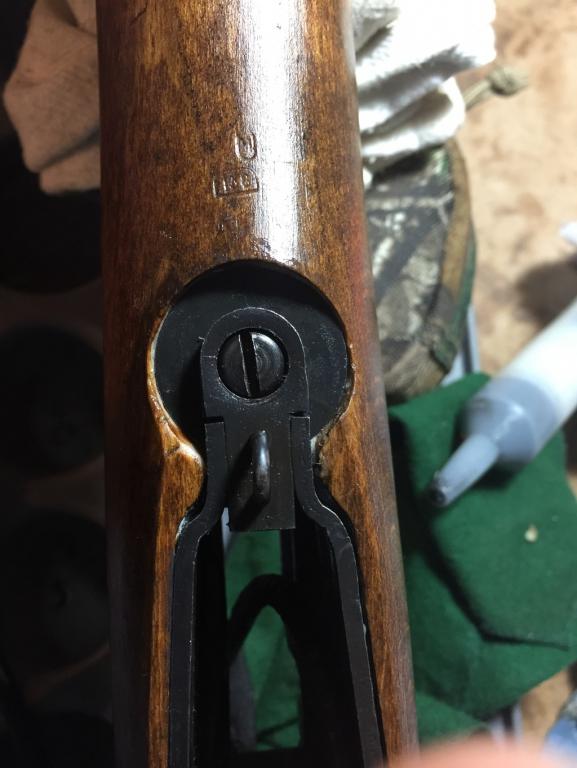

    First of all, hello! First time poster here. Looking for some guidance and/or constructive criticism, it's my first time wrenching on a Lee Enfield so I have lots to learn. If you see something out of place or questionable, please let me know!

    - I installed a 1.25" diameter wide washer as a pressure plate under the trigger guard/main screw, and bedded it

    I think you will find that cork will gradually compress over time and you will use your up pressure, I have 2 No.4 workhorses and one is traditionally bedded with the up pressure the other is hard bedded with no barrel movement they both shoot well and I have not noticed any changes in the POI in the hard bedded one during rapid fire events. The knowing ones will chime in shortly but I would beware of it touching the top woods as you alluded to it may be they suggest fitting in a block of oak or similar hard wood and routing and rasping until the desired profile and up lift is achieved just my thoughts. I also have Wadhams book pretty good source of info I reckon, others may disagree with some of it.

    Muzzle bearing pressure. I would cut out a 1.25" long x 1/2" wide section at the muzzle and insert a wood patch. Radius the top to suit the old cut-out muzzle bearing and rad of the barrel then slowly start to lower it until the barrel bearing comes down to the weight required. But don't go any further if the barrel isn't central in the muzzle end of the fore-end as you have already passed the point of no return regarding any further correction of that particular problem.
    I think you were a bit hasty with that, er........., fugly* washer at the front trigger guard screw. You could simply have used a reinforcing plate as per the L42 rifle and be done with it.
    Handguard touching the block band foresight. Simple. Move the BBFsight forwards a tad to get clearance or just dolly/reshape the metal end cap to achieve the same

    Thanks to you both!
    CINDERS - I will look further into the fitting of the bolt. If I feel out of my depth, I have a gunsmith (@ Ellwood Epps) an hour away and I'm fairly certain they know their way around a Lee Enfield.
    Peter - It is quite fugly, no doubt. I think more on account of the mismatched wood than the pressure plate though! I am okay with function over form, though, and seeing how much this rifle has changed has made it mean something special to me regardless of its looks. My intention, however, is to make a wood plug to cover the washer, and make that area by the main screw less conspicuous.
    When you say ventral at the muzzle, I understand that to mean contacting the wood of the fore-end under the muzzle? My barrel is currently doing that, without modification, but the up pressure is quite low (maybe around 1 lb). So I am to effectively raise that section up higher to increase the up pressure? Sounds better than my cork plan!
    Regarding the band block foresight, how would moving it forward work with the pin which holds it in place?

    Ah, yes. Ventral now changed to CENTRAL! Take the pin out! If the BBFsight is a nice drive-on tight fit on the lugs it won't be going anywhere. We used to tin the lugs to achieve this. Some of the less cautious butchers would swage the edges!
    Get the muzzle bearing up to the CORRECT weight. Once the muzzle lifts clear of the fore-end as the bullet is thundering down the barrel, the barrel is what we call 'out of control'. OH yes it is for those who still think/know differently! There is a simple student experiment to prove it too.
    You ain't going to get a successful wood plug to cover that fugly washer but I agree, aesthetics are secondary function in weapon design
