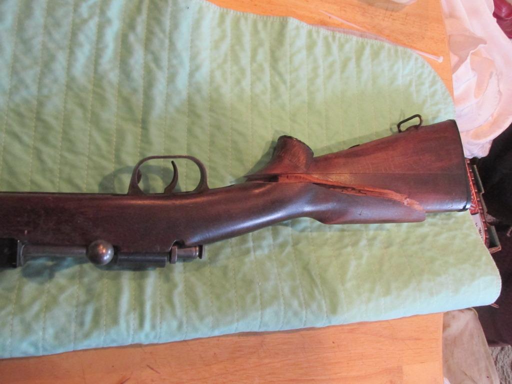

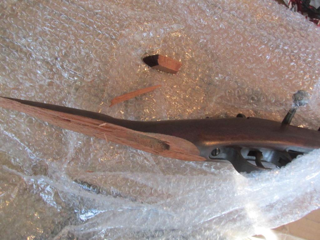

    what is best way to glue this shipping damage. Can it be saved or just replace.
    one is a Remington 22 pump split down wrist. 2nd is Carcano busted right off

    Easy repair using the correct WOOD glue, clamped for 24 hours. Next day, strengthen by using 2 turned oak dowels along the line of the break, glued and knocked in. Will last another lifetime. Done loads of them.

    Carcano has a sporterized stock so not much good for parts anyway. Looks like a Type I that is missing it's floor plate. Not Italianicon but Japaneseicon. Italian made. Parts are more valuable if that's what it is.
    I also see what appears to be the standard Japanese split stock.

    Sticking with the Type I theory. Looks like the took the rear sight off the barrel and tapped it for a civilian peep type sight. Not worth restoring, too costly plus the drilled hole in the receiver for the sight.
    Caliber is 6.5 Arisakaicon, not 6.5 Carcano.
    Very few if any parts are interchangeable with the Italianicon versions. Bolts are different, close but they don't fit.

    I have bought off this company alot this was first time having multiple firearms shipped in same box getting damaged. the brown truck might have road over it. Company is making good between us. but brown said it was not shipped in original box so not there fault.
    Steve i just wanted this one for a shooter for the kids so might give it a whirl an put it back to shooting shape. will cast bore to make sure what it is.
