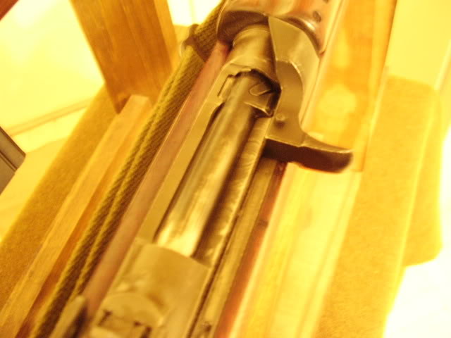

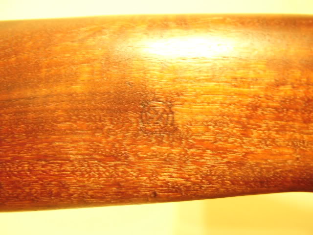

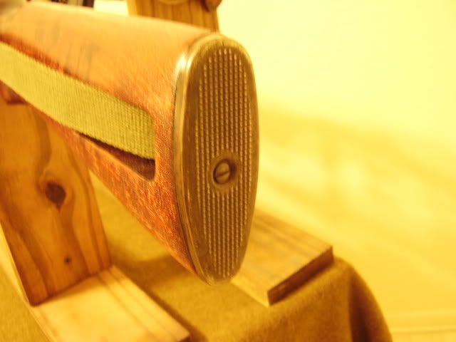

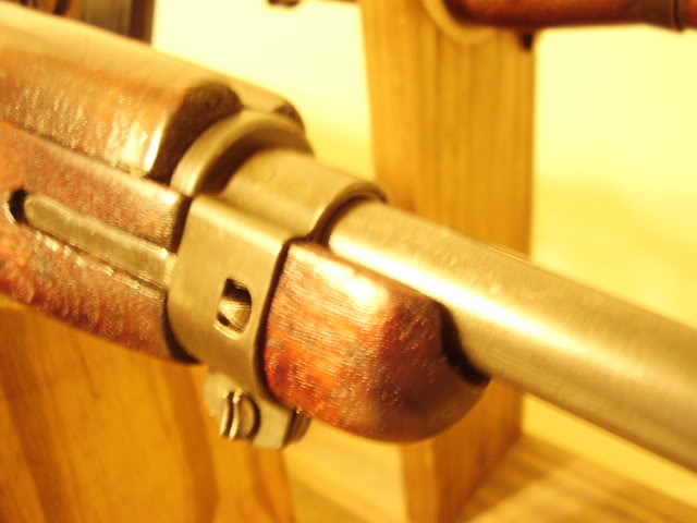

    picked this one up today at a local funshow. it appears to be an all correct original Winchester just finished up a data sheet for the Carbine Club the only thing that is out of wack is the N coded front sight can't find anything in Warbaby or the CCNL's that i have about any transfer of front sights to Winchester except for a circa 1944 transfer of parts unspecified from both Saginaw and Standard Products that is in Warbaby. all parts are correct per Warbaby for the vintage but the front sight, anyone else have an N coded front sight one their Winchester rifle in this range? any thoughts. here are a few rough pics.

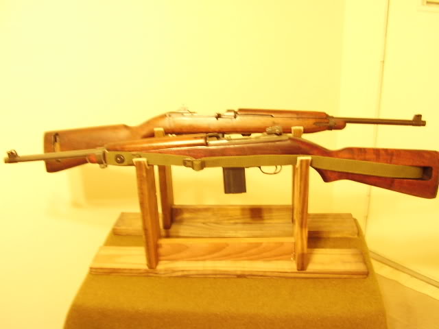

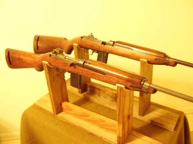

    Here's a pic of my Father's bring home 5,573,898 and my 5,811,227.
    5,5 in back, 5,8 in front.
    Regards

    can't see any evidence of if being removed/replaced. it is the only thing about the rifle that is out of place everything else is as it should be. no type 3 barrel band shadow the rear sight is factory staked it's a head scratcher for sure.
