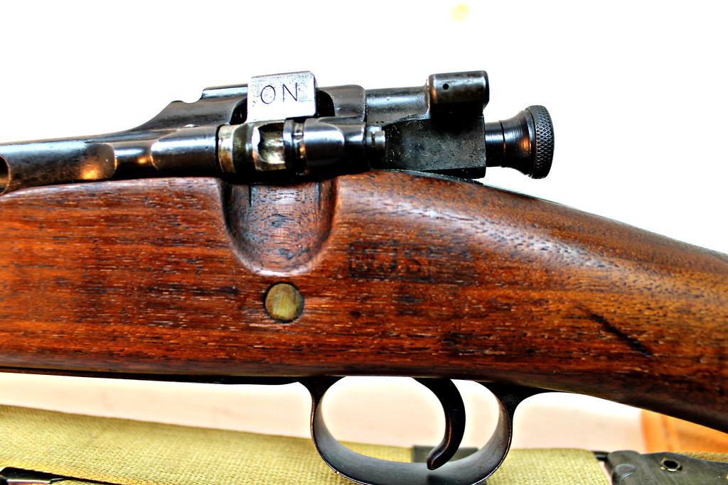

    I have had two of the Mk1's. If I remember right, the first one I had didn't have any other stamps other than the "P" proof. I picked up another a few months ago and it has a "WJS" cartouche in the usual place. I am positive that this one is an original rifle as it too, has all the correct Mk1 bits on it and the finish condition matches throughout.
    I tweaked the contrast a bit to highlight the cartouche

    Thanks for the post highpower. Yeah, all mine has is the P. No other stampings.
