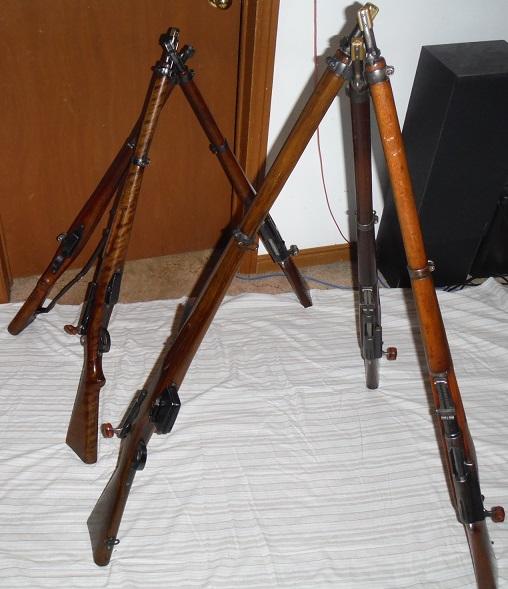

    Pile Arms, first group is a I.G. 1889, a I.G. 96/11, and a I.G. 1911 (I.G. referring too Infantrie Gewehr). Second group is two K31s and a K11 (K referring to Karabiner).

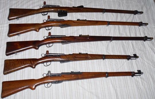

    In order from the top down, we have a I.G. 1889 made in 1896, a I.G. 96/11 made in 1904, a I.G. 1911 made in 1915, a K11 made in 1914 (also first year of production for the K11), and a K31 made in 1954.

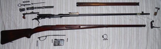

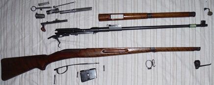

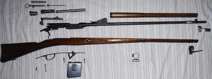

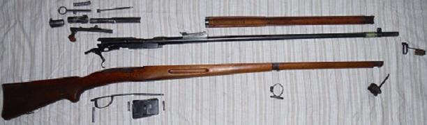

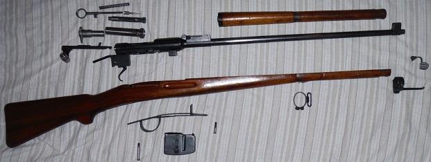

    Expanded view of the I.G. 1889

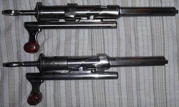

    Comparison of the 1889 bolt (top) and 96/11 bolt (bottom). Note the rear locking lugs on the 1889 which made the action so weak, and the size difference between the two, the 96/11 bolt being smaller and the locking lugs moved forward. The 1896 updated bolt would be the final improvement to the bolt design of the Schmidt Rubin.
    Expanded view of the I.G. 96/11
    This shows the magazine cuts on the 96/11 vs the magazine cuts on the 1911. As you can see it is much more intricate on the 96/11 as it originally possessed a 12rd magazine like the 1889.
    Expanded view of the I.G. 1911
    Expanded view of the K11
    Expanded view of the K31. Note how much less parts are used in the K31 vs the 1911 rifle and carbine and that the aluminum collar has been removed from the design.

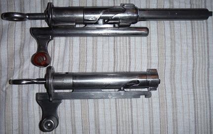

    Comparison between the 96/11 bolt and the K31 bolt.
