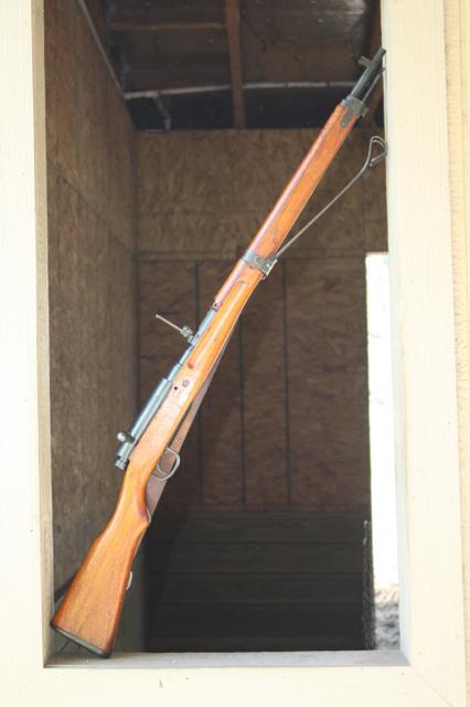

    Model 99 Arisaka
    For reference. Mine is a 4th series Nagoya, 29,000 range. It sports AA sights, matching cover, and monopod.

    i can't help but say, fix that dust cover! its out of position and will scratch the receiver when the bolt is worked

    Quote Originally Posted by Marines55 View Post
    I just threw it on for picture purposes, otherwise it the accessory pile in the safe.
