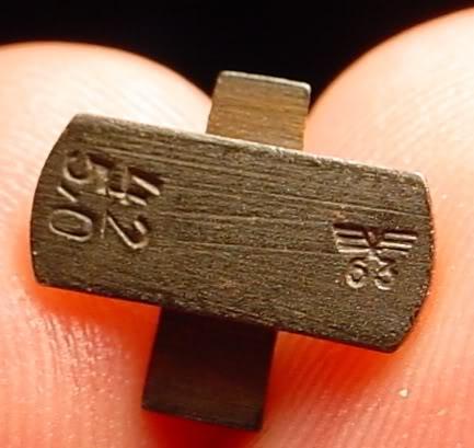

    Quote Originally Posted by Steve762 View Post
    Easy fix! Slide the rear sight up to get the vertical shot placement you want.
    Once again, a photo would save reams of speculation. But a photo of the front sight might well reveal that the blade has been seriously filed down, as a fix for the usual high POI of ex-military Mausers. This is commonly done to get the POI into the black with a backsight leaf setting that can be varied to suit different types of ammo.
    So Steve's answer is correct. The sight was probably so drastically shortened because a previous user was shooting lead bullets, at a much lower velocity than any jacketed bullet. There is nothing wrong in that, as you adjust the backsight leaf to suit, but if it bothers you, get a replacement foresight blade.
    Post a photo of the foresight, so we can all see if I'm talking tripe!
