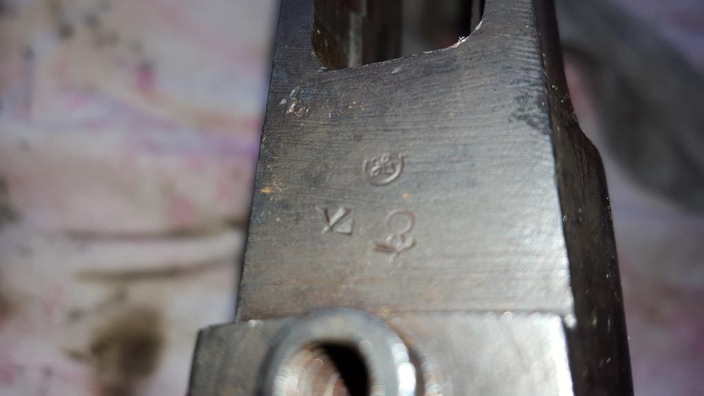

    Do the markings indicate anything particular?
    Got any links to Spanish Mauser identification/markings?
    Was this made in 1951?

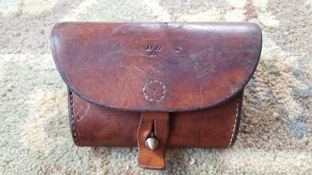

    Whats really neat, is I got this ammo carrier, which holds alot of 8mm

    Your ammo pouch unfortunately is Swedishicon. Three crowns are a dead giveaway. Swedes also used a 6.5 round although the cases are about the same size so you could use it.
