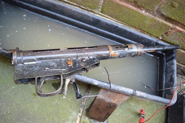

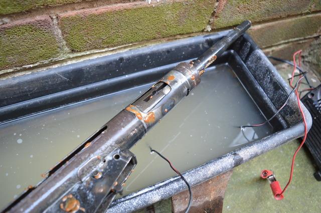

    Just about to do the electrolysis treatment on mine so ready for the bead blast, as I've got to do the crowns on the phone box....... (see watering hole) good excuse to do some cosmetics on the
    MkV too.
