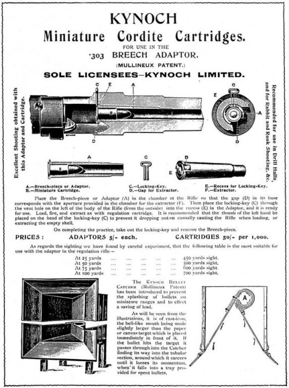

    Here is an excerpt from Kynoch's 1901-02 price list: (Also see Miniature-calibre adapters and conversions for Enfield Rifles )

    Nifty "snail" bullet trap there.
    Love the price of the cartridges: 50 shillings (4.5 real pounds, Sterling) per THOUSAND.
    Then again, in those days, that was probably close to a week's wages for the basic punter.
    It can't exactly be rocket surgery to whack a piece of 4140 in the old lather and turn up something similar to use .32 S&W / .32 Colt, etc. if one were so inclined. The more adventurous (and well-heeled) could try 7.62 Nagant.
    Did these "special" cartridges have a slightly large diameter rim so that the .303 extractor would engage the case properly and actually "extract", leaving the adapter in place?
    The thing about the good-old rimmed .303 is that you can use, and re-use, the full-sized case for "gallery" loads as long as you take care and use a "bulk" powder that takes up a LOT of space for weight. If you are running a Mk1 Metford, you could even use REAL Black Powder or Pyrodex for some extra "authenticity". A "heeled" bullet as found in some of the "Rook" cartridges and having a max diameter of about .317 may be useful as well.
    Dust off the pith helmet, ammunition boots and red tunic and have at it, as they say in the classics.

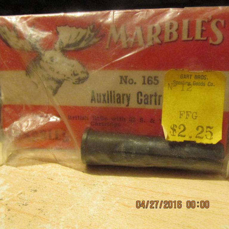

    here is a marbles one i picked up still sealed in package

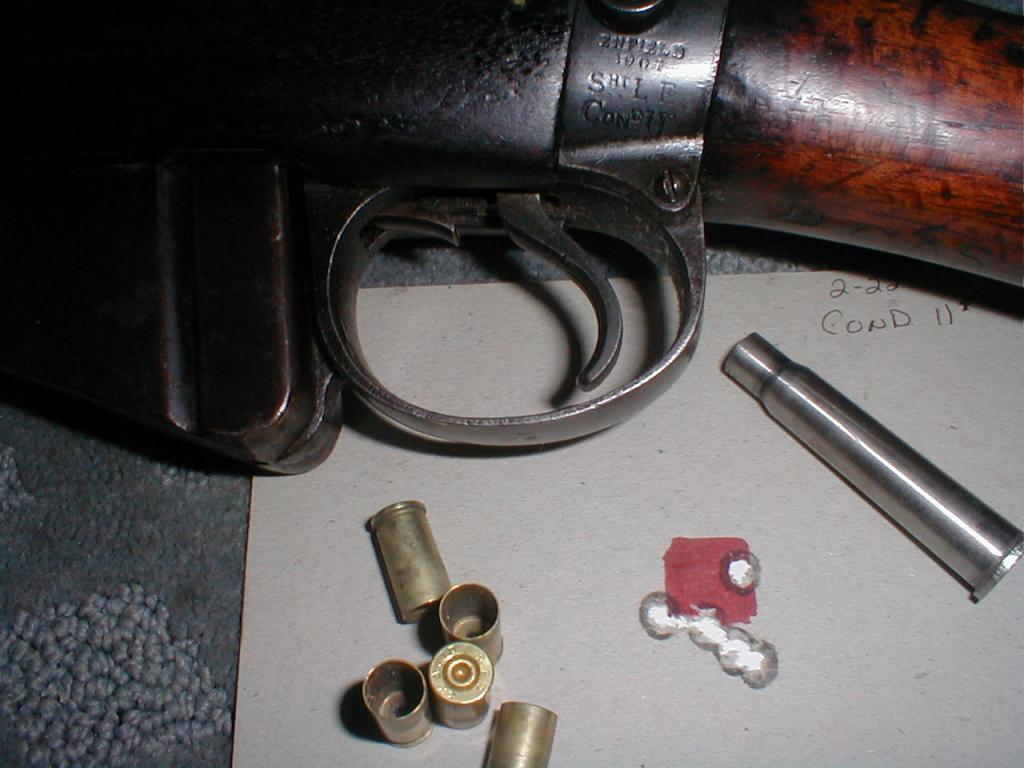

    32 S&W adopter in 303 rifle chamber
    these have been around for some time, 32 ACP will work too
