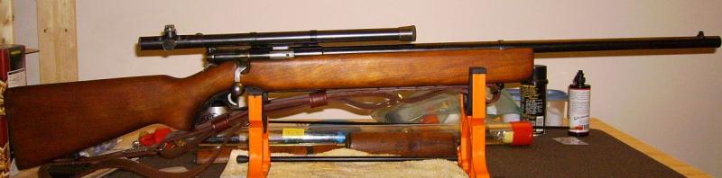

    Took my M4 scoped 44 to the range today. The safest place to stand was in front of my target. The rifle had no failures. How do I sight it in?

    Boresight your rifle. To boresight a rifle you first remove the bolt from the action. Put the rifle in a cradle as shown in the picture posted. Then look down the barrel and center the bore view on a object say 15-25 yards away. Then look thu you scope and carefull not to move the rifle adjust your scope up and down to be on the same object you seen through your barrel and you will be on target for sighting in. It may take couple times. Saves on ammo also. Good luck.

    You may want to move your scope a little more forward so your head is in a more comfortable position. Your correct eye relief is probally between 2-3"
    good luck!
