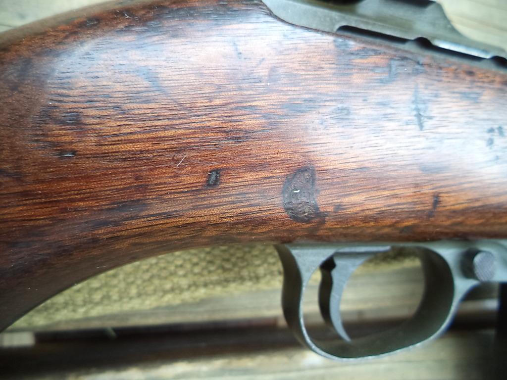

    I have added the images you requested as well as a few additional ones. Would you mind educating me about what you're looking for? Always want to learn new things from the experts.
    I've also uploaded a few pictures of something on the stock, right by the M1icon Carbine stamping I've never noticed before. Not sure if it's just a hickey in the wood, or if it's some sort of stamping. I'm going to research but if anyone knows what the mushroom looking thing is I'd love the info.

    Three on the stock are ordnance mark, flaming bomb and Overton Lumber stamp...is that what you refer to? Or do you mean on the top left edge? I suspect the stock has been sanded at the bottom which would suggest further issue by another country at some point, perhaps that's what it's from?

    I'm familiar with the three markings in the sling well.
    There is some other sort of something on the top of the stock, even with the words at the front of the receiver. Almost looks like a mushroom or something.
    Might just be a ding in the wood but it kind of looks like it was done on purpose.
