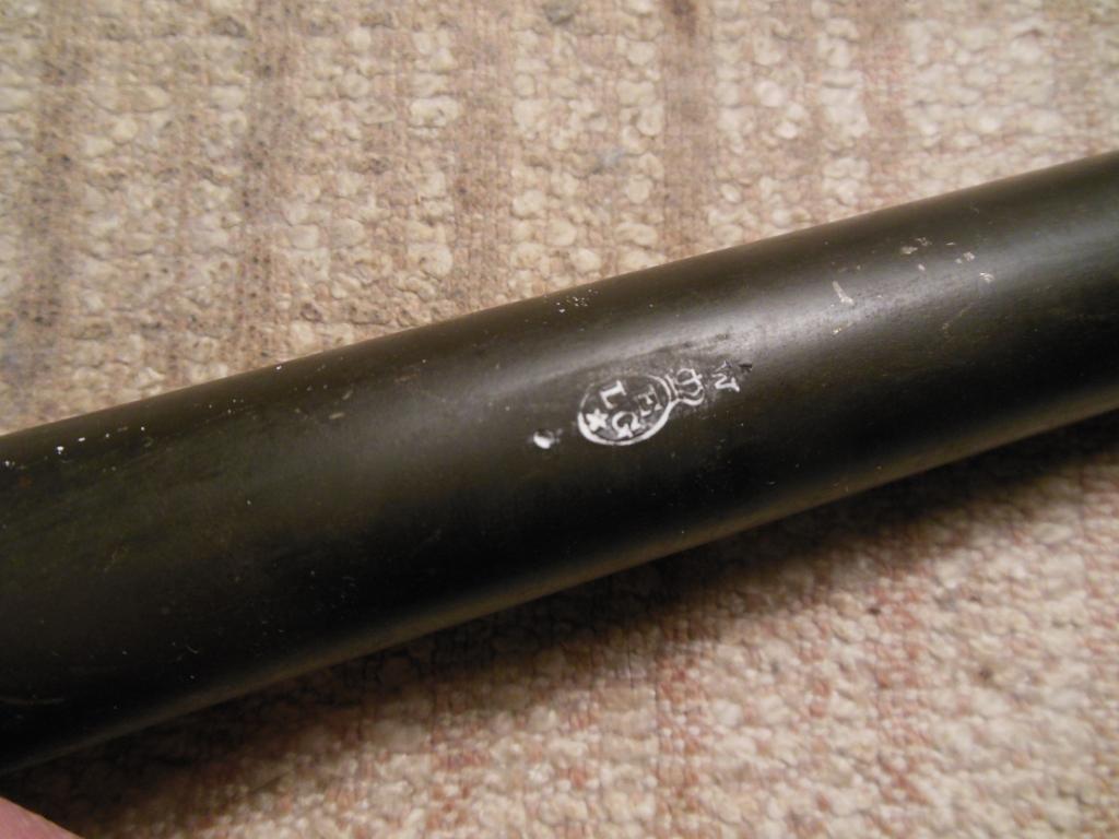

    Identification of Browning barrel in 303 cal
    this barrel was found among some BMG M1919 barrels, it is chambered for the 303 cartridge and fits the US barrel extension. Which variation used this barrel (think it is FN)

    FN 30 would be my guess.

    I had a couple in Gagetown and I don't recall seeing that large barrel bearing or booster up front.

    That's what's puzzling me BAR. We had a couple of RAF .303" Brownings at Warminster. But the barrels didn't have that. The dish shape at the muzzle makes me think it's part of a recoil booster. I feel sure that the breech thread were standard lock frame threads

    I did find some additional information on this barrel. I believe it is an aircraft barrel manufactured in Belgiumicon that could have been used by air forces in the Baltic States. Both Finlandicon and Portugal
    plus some small South American air forces also used FN Brownings in their aircraft both in 7,92mm and 303 Britishicon. At first I thought it might be 7,7 Japaneseicon rimmed but they only copied the larger
    Browning design for their 12.7 and 20mm projects

    I can tell you it was made in Belgiumicon as that is a Belgian proof marking on the barrel (so FN is very likely). Otherwise I have nothing to add.

    When I first saw this Belgiumicon barrel with the muzzle booster it reminded me of the Browning M1919A6 barrel which is light weight but also with the larger diameter at the muzzle

    It is a FN Modele 38 barrel, AKA FN 30. The 30 obviously refers to the 30-06 round and has been used to designate the model which it shouldn't. Only the Modele 32 and 38 in 30-06 should be referred to as FN30, I suppose a 303 version could be called a FN303. Anyhow, try googling FN Modele 32 and 38.
