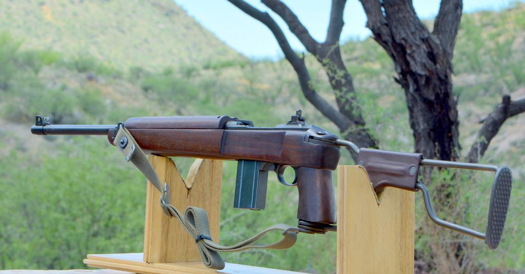

    There is a M1A1icon on sale online at gunbroker ($3k with 3 days left) and I noticed something that seems off. I am new to these so I could be all wrong about it.
    I read that the cutout section of the stock left side where the cheek pad rests is supposed to have smooth flowing curves in the first production carbines. This one has sharply milled edges in that area same as the reworked stocks have. Am I wrong or is that not correct for a first production paratrooper?
    Also noticed that the cheek pad doesn't fit the cutout when the stock is folded. On mine it fits exactly in the right spot.
    In another pic it looks like the leather pad is not fitted well to the base metal.
    The sling has absolutely no wear at the points you would expect even if lightly used.
    I've been looking at details of these for a solid week trying to determine if mine is legit and now I am noticing oddities in many online examples. Has my imagination gotten the better of me?

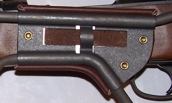

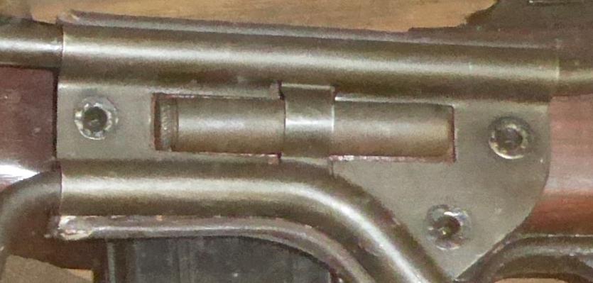

    Second pic:
    Red Arrow: Machine mark to secure cheek plate is very distinct and just like the one above on the barrel band. Mine has a mark but it is a simple indent.
    Blue arrow: Curve of the folding wire stock starts farther out and is sharper than mine which starts right at the exit from the plate.
    Green arrow: Rivets on the for sale one look like they are not brass or have been parkerized. My example clearly shows brass rivets.
    Overall the cheek pad plate doesn't seem to fit as neatly as mine does and is not mounted in the correct position to let it rest in the cutout when folded. However the way it was made would not let it be moved back to allow correct fit.

    Hey Bill take another look at the details. Here is a pic of a the stock folded. The one pictured above doesn't fit. Can't be original. Below is a pic of the recoil plate cap on the one for sale. No way that was passed by ordinance inspectors. That has to be an aftermarket repro part or the stock is. No way they came off the line together.

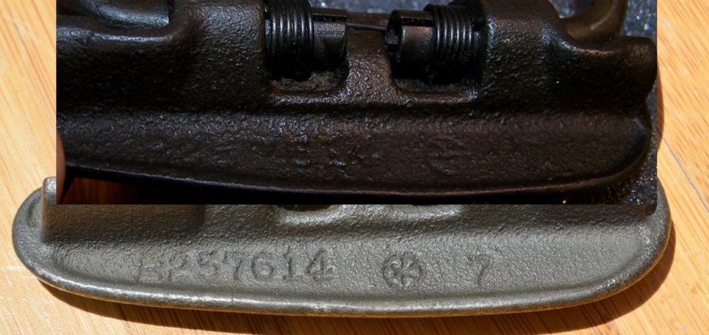

    Buttplate. Mine on top. The for sale one below has finer casting and a fatter rounded edge. Most evident at far right in the pic.

    Everytime I look I see a problem: Notice the star symbol on the buttplate? Different on the for sale gun. That one is only an asterisk and the crossed lines are oriented at 12, 2, 4, 6, 8, and 10 o'clock instead of properly at 1, 3, 5, 7, 9, and 11 o'clock. According to uscarbine30cal.com all of these were cast by the same foundry.
