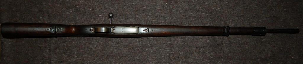

    Remember these?

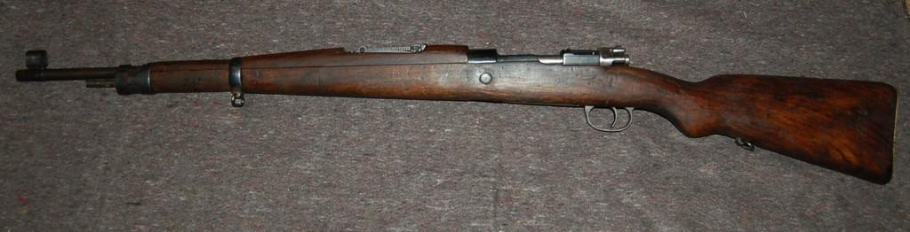

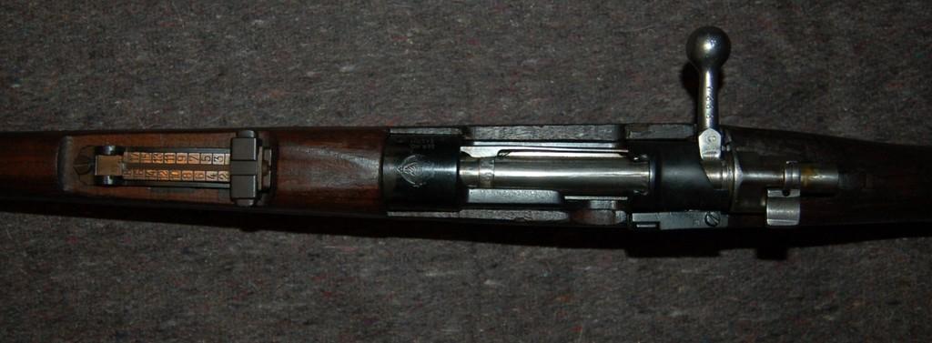

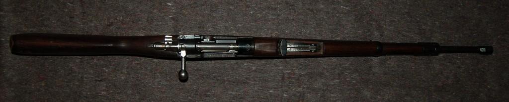

    Mike got them a few weeks ago after a gun show. I met up with him in Scranton and picked one of them out, not sure which from the above photo but suspect it's the one on top of the pile middle left. Made a rookie mistake and grabbed a nice looking one that was in an M48 stock without thinking. Missing the handguard and some of the metal stock bits I figured I'd make a shooter out of it and would keep an eye out for a hand guard and the metal bits in the meantime.

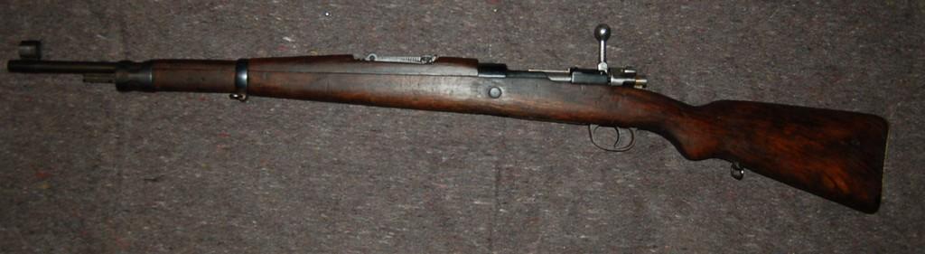

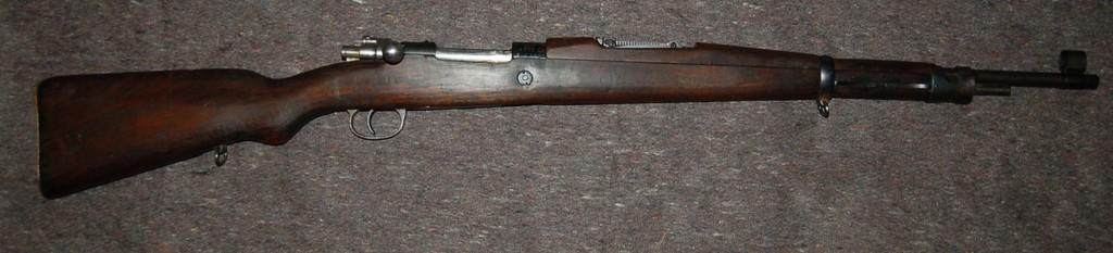

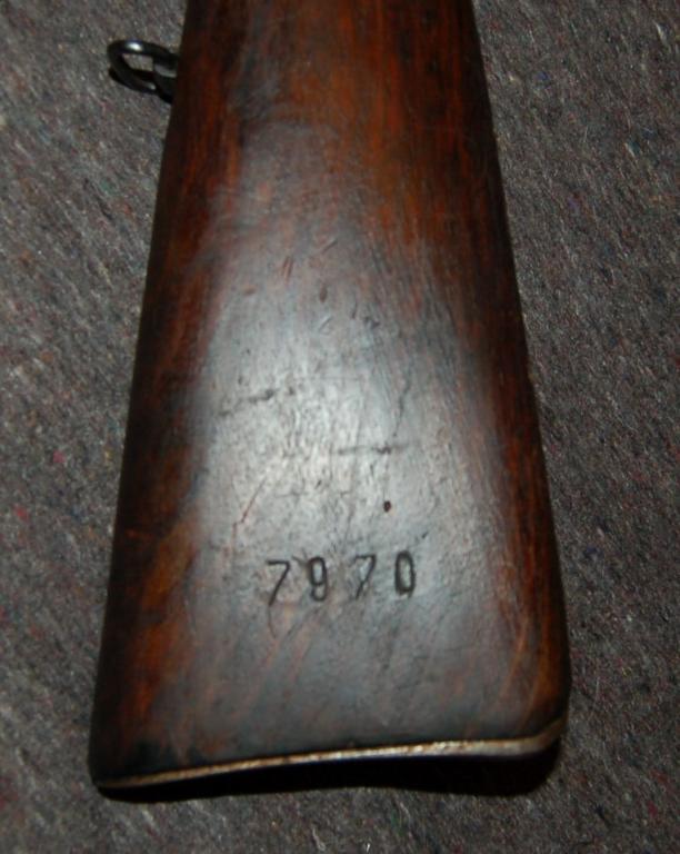

    A complete 24/47 stock showed up the other day on ebay, not in the military category which is probably why it didn't get noticed but I was able to snag it for $37. Wasn't supposed to come until Thursday and I figured I'd need to do a deep cleaning on it but when it arrived today, I figured I'd just do a wipe down and see what it looked like. Not too bad. Stock has no major dings, hand guard matches stock, quite a few letter stamps and a few small cartouches that didn't show up in the photos. The barreled action was in pretty decent shape. Finish rough in spots and some active rust in a few places but cleaned up well.
    So thanks Mike, this came out really nice.
    Stock looks a little dull now but with a few fresh coats of oil should get a nice glow to it.

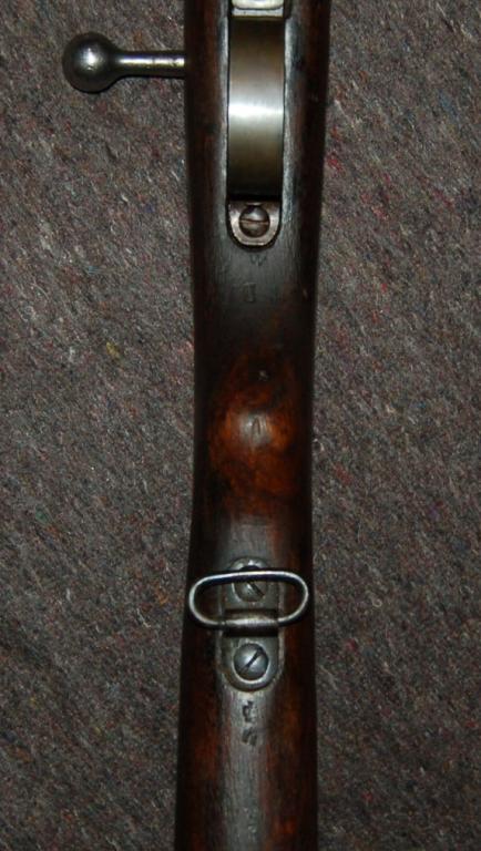

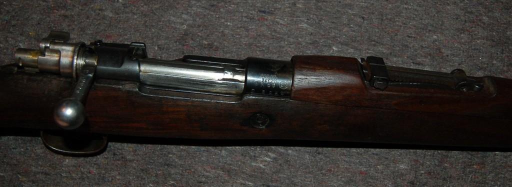

    Some pics to help...
    Attachment 75287 Attachment 75288 Attachment 75289
    The composite photo on left and center photo show a "rifle" and a "carbine" type II. In Yugoslav military parlance a "carbine" was any long arm with side or dual sling attachments. Size or length did not enter into it. The only difference between the type I and II carbines were the bolt and the last image R show the type of bolt that was used on the type I. It differed from the later M40 bent bolt in having more of an ess or "S" shape sometimes called 'serpentine' profile and the flat on the bottom of the bolt arm ball was finely checkered compared to the M48 which is flat.
    The 24/47 stocks you see with the plug in the wrist/butt are former carbines converted to "rifles" by the Yugoslavs.
    That should help some folks to a better understanding I hope.
    Congrats on a good job of rescuing a fine arm.

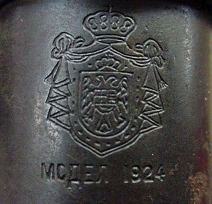

    Here's an M1924 manufactured in 1929 for the CXC- Kingdom of Serbs, Croats & Slovenes. (This is a restoration of mine as a matter of fact.)
    The crest compared to post WWII
