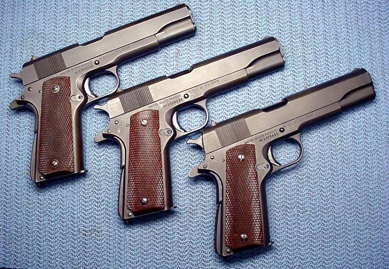

    Here are 4 US&S pistols with various Keyes stocks..

    John-the US&S that I was inquiring about (a 98% pistol) is 10736XX and it has Keyes grips without reinforcing rings. Very close to your top pistol. Do you mind revealing the serial # of the other two. Thanks for the pics--they do clear up my concerns.

    The middle right is 104XXX and the bottom right is 108XXX.
    I have observed many US&S pistols and it seems like that both types of stocks were used throughout production. So in my opinion either is correct..... They should fit the condition of the pistol they are on!!!!!!

    John--thank you again for your knowledge and your fine photos.--charles
