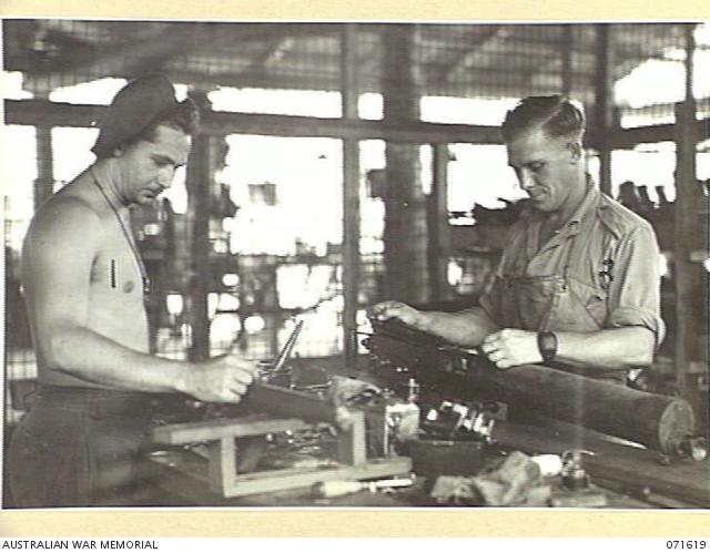

    Today @ 02:20 PM
    30,996
    04-25-2025
    12:54 PM
    Some good pics, working out in a tent...

    Today @ 12:48 AM
    8,098
    04-26-2025
    03:54 AM
    Isn't that a young P L 2nd last pic far end of tent when he was over here learning how to do things the Aussie way????

    Funny you should say that Cinders but I learned pretty quick. One day I looked through a cupola opening to querie something that someone had said about doing something and commented words to the effect that '.......that's not the way we did it in Englandicon.......' That's as far as I got when Johnny Cotterell said in no uncertain terms '.....well get hold of your tool box and xxxx-off back to England then'. Guess what you do when you're in Rome........? Yep...., quick lesson. Turned out to be one of the best blokes I even knew. Went to Oz as a boy from Reading.
    Photo 3 and 6 looks like they're working from the let down sides of their Armourers workshop lorry. Ours was an old Bedford 77YC16 that towed a 110v generator trailer. We also had a couple of bigger pommie Commer BH type Binners as I recall. We hardly ever wore shirts at work, just shorts and short leather ammo boots that you see. But later we gradually got rubber soled shortie boots with socks rolled over the top. From about '68, calf length black leather rubber soled leather boots with grey or khaki socks rolled over the tops. The sweat used to run down, soak the tops of your socks and then run into your boots so you'd squelch around. Best were the canvas and rubberised jungle boots but alas, no real protection
