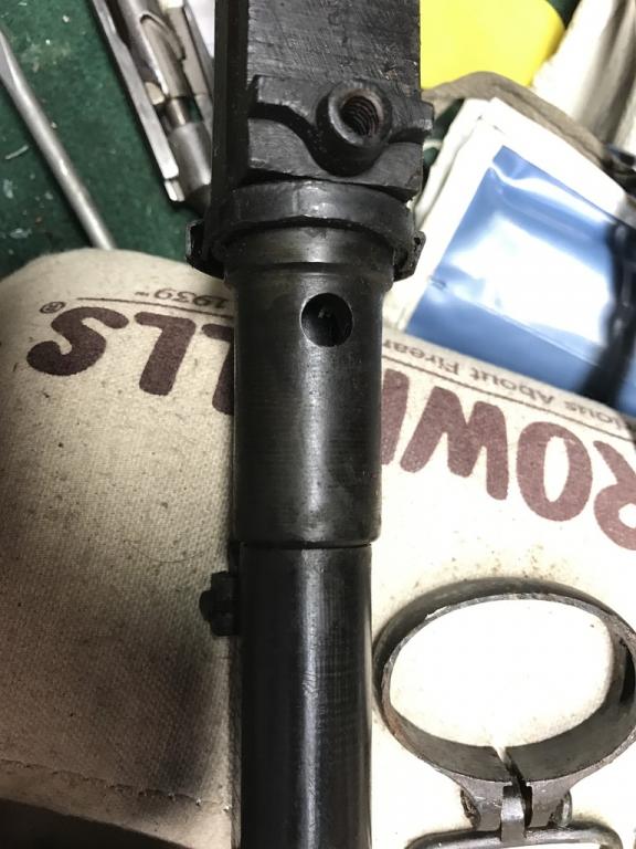

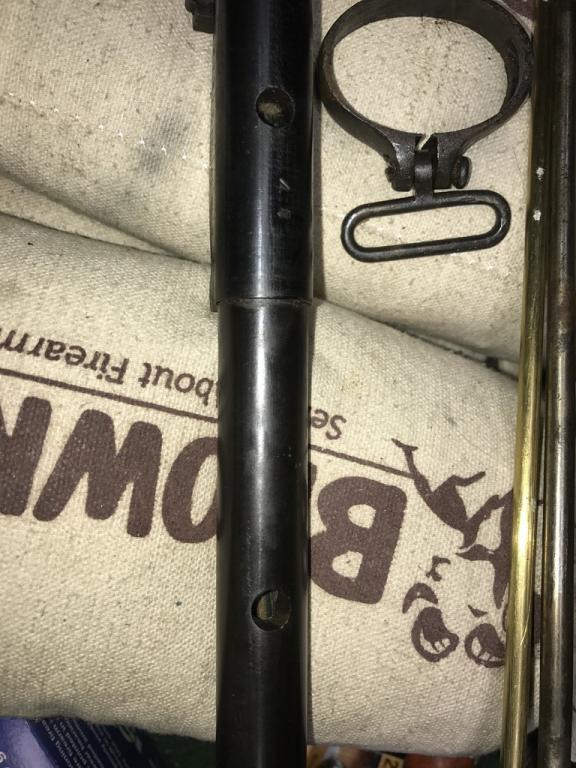

    I am putting this out there as a warning. Recently a ton of Samco Spanish 7mm Mausers hit the market. I recently picked one up at a gun show for $100 after digging through a pile of ugly guns. It had shellac on the stock but metal was pretty decent. When I got it home I tore it down for a clean up and found a pretty horrible surprise.
    Three holes drilled in the bottom of the barrel. Yep, deactivated parade/drill gun. There are absolutely ZERO marks externally on the gun to suggest this is the case. Had I been careless and put live ammo in this gun without checking it, it would have been a disaster. The holes were pretty cleanly milled and not obvious when looking down the barrel, with the minor burrs present being easily confused for gunk/cosmo in the bore. A few runs with a .270 jag to clean the bore went fine.
    The only external signs to watch for is a shellac finish on the stock and black paint on the rear sight. Mine was the original 7mm caliber, mis matched bolt, no crest. Firing pin hole on the bolt like normal, and the firing pin protrudes when deocked. These guns will very likely fire if loaded with a live catridge.

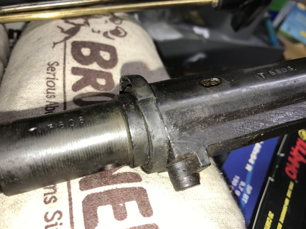

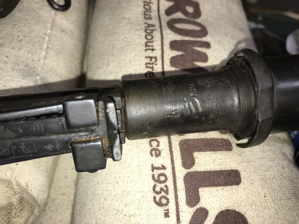

    The firing pin is full length. I did drop a round into the chamber (with the bolt disassembled and stashed elsewhere) and noted it would not quite go all the way in. Unfortunately since I had no dummys/snap caps I could not actually install the bolt and see if it would go into battery though I suspect you'd have a hard time doing so.
    I was not able to make it back there today as I had a shoot. However, it is a dealer and I have their contact information, so I plan to call them tomorrow. The only interesting thing is the "T" letter prefix on the serial. However, this is a normal prefix as far as I know and it does not appear a prior prefix was scrubbed. Still I included a picture in case anything stands out to anyone about the markings on the gun.
