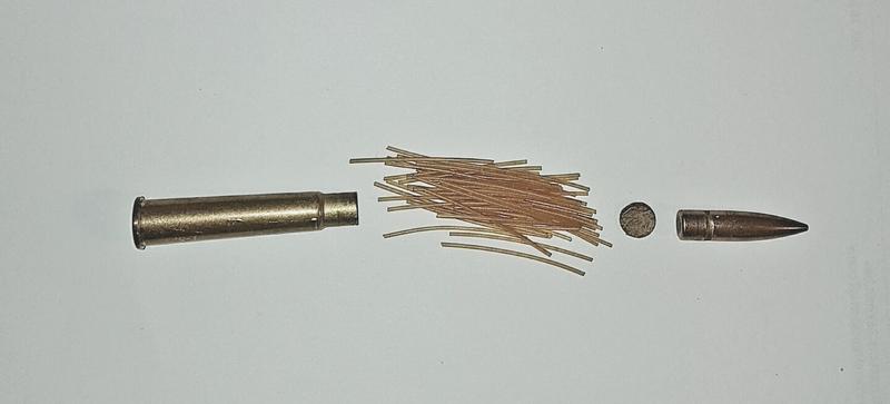

    A friend presented me with a hundred military .303 Britishicon rounds of 1942 vintage in excellent condition. Nevertheless, I didn't feel like shooting corrosive ammo in my pristine bore, so opted for dismantling in order to recover the bullets for handloading. They came out easily with the inertia hammer but I was surprised to find only a bullet but no powder in the hammer body. Inspection of the cases showed these were loaded with cordite, with a cardboard washer (gas check to protect the bullet base from the cordite heat?) between charge and bullet. Bullet weighted 171-175 g and cordite load around 38.0. What really puzzled me was how tightly the cordite strings were packed into the case. I had to pull out the wad, then several strings of cordite with thin tweezers before the rest of the charge got loose enough to come out ?!? I wonder how the production lines operated as they obviously didn't meter by weight/volume, neither could they drop the charge as commonly done with regular rifle powder (sticks, flake or ball).

    The cordite was dropped before the case was necked down. Surprisingly the cordite remains stable over the years if stored right. It's the dual compound primers that go. This causes click bangs (I''m told that official Britishicon nomenclature...wink) and extreme velocity spreads. I pull it down to but if the primers didn't deteriorate I'd shoot it and clean accordingly.

    I've received quite a quantity of that type of ammo from a local antique and curio shop as they have it dropped off with "Stuff" regularly. I'll take it home and prime a fresh case and re use the cordite stick and all. To remove the cordite, just take the bullet out of the inertia puller and give it a couple more whacks to start the stick out. Then the treat is stuffing it back in. I only had one that was so curly-cue I couldn't get them all back, missed a few but all went well. I don't shoot hangfire ammo...
