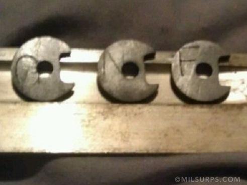

    I bought a set of OKIE gauges. They work ok if you use them properly. I checked the spec's with a micrometer and they are correct.
    They are slightly magnetised, which does help keep them in place on the bolt head; but best to have the rifle verticle so as to avoid slippage.
    I would prefer a set of original gauges; but these are definately better than tape stuck on an empty case!
