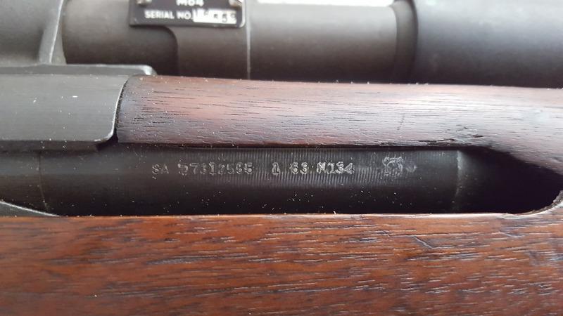

    Hi all,
    I recently purchased an all IHC M1D less the barrel which is SA.
    The receiver legs have no electro penciling as to who did the conversion. Is this something I should worry about?
    The barrel caries the proper D731555 on the right side (haven't looked under handgaurd)
    And is dated 58 or 53 can't tell.
    I guess my question is, is this a proper depot build or an IHC with an M1D barrel home build?
    Jon

    Confirmed barrel date is 1953.
    Serial puts the rifle production in 1954-56 range being 515xxxx

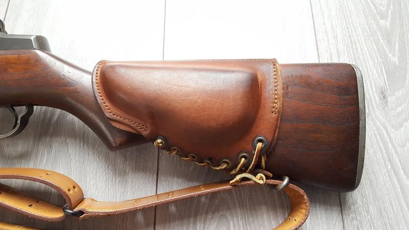

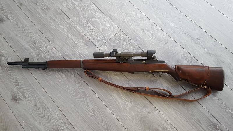

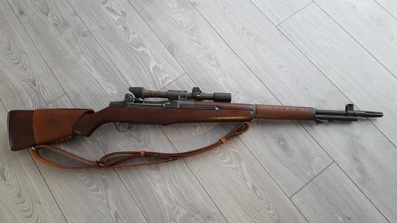

    Here she is!
    All correct IHC except the 555 serial M1D barrel and SA M1D stock.
