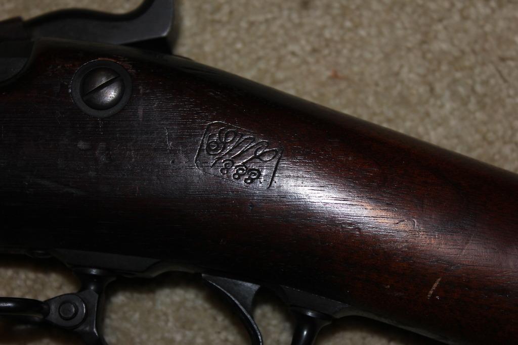

    Hello everyone.
    I've perused the info and impressive rifles here for a while, and I recently purchased this Model 1884 Springfield. It has an inspector's mark and serial number production year of 1888. Looks good overall, although the inspection mark seems almost too clear compared to what I have seen on other rifles.
    Rifling looks good, and at some point I plan to hand-load some rounds to put through it. I've looked at developed loads elsewhere (the Trapdoor Collector website, most notably). Anyone here have any favorite loads they'd like to suggest?

    Welcome to the forum, you should have a look through a few books and see what they recommend, some will come to you here but check them against verified information. Nice looking rifle. You say the barrel is good?

    From what I can see, yes. I don't have my good bore light on hand, but I can't see much (if any) sign of pitting and the rifling looks reasonably sharp.
