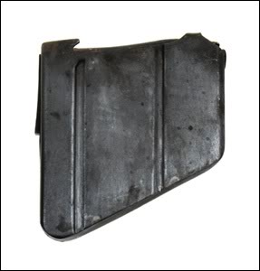

    I'm not able to take pictures right now.
    I found a picture of the breech area of a No. 1 rifle. You can see one of the front magazine tabs sticking out in front of the hump on the magazine follower.
    The other pic just shows a side view of a magazine.
    Smead had a lot of good suggestions.
    I would take a close look at the front tabs.
    If one is higher than the other, I would try to gently bend it down so the tabs look the same on both sides.
