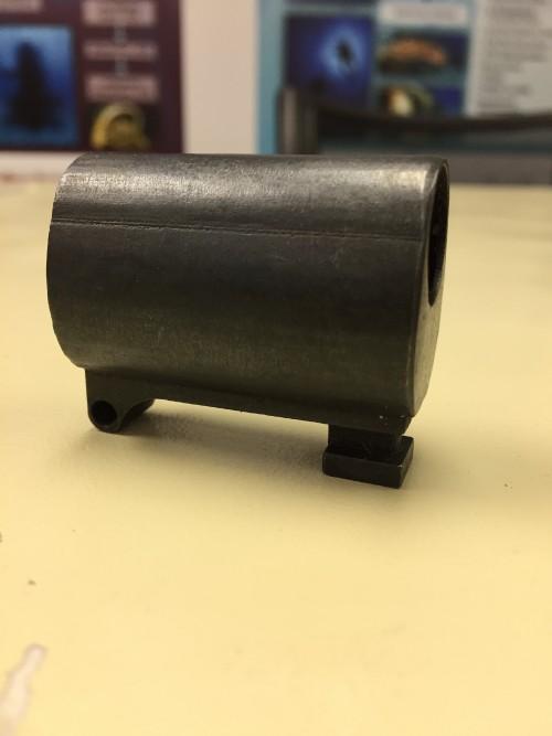

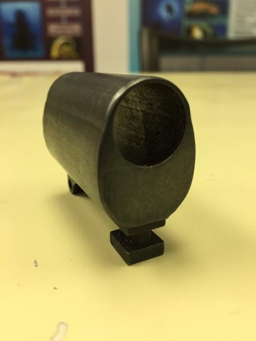

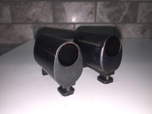

    Been busy again trying to get reproduction ross parts made.
    I sent in one of my 3d files for the MKII 3 Star Nose cap to get 3d metal printed. Received it yesterday and cleaned up the print lines and did a quick cold blue job on it. Image on the left is 3d printed one.
    The process of 3d Metal Printing uses 60% stainless steel and 40% Bronze. So it is tough. Used a propane torch on it and didn't distort at all! Way hotter than you would get shooting a bolt action.
    I have 3d drawings done on MKII 2 star (Heavy Barrel), MKII 1 Star and Mid bands. These will all be 3d printed. Cost associated with getting stamping dies are prohibitory expensive!
    Thanks
    Lorne
    Left one is 3D Metal Printed.
    Uploaded at Snapagogo.com

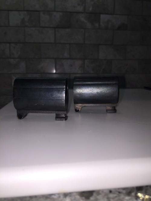

    All depends on size of the object and material selection. Quantity's ordered depending on supplier is also a consideration. Less you order the higher the price in some circumstances.
    Post print smoothing is also required as you have lines running horizontal through the work. The mark II 3* took about 1 1/2 hours of filing, sanding and polishing the lines out to make it smooth.
    Below link is pricing for the finished product.
    http://www.milsurps.com/showthread.php?t=62167

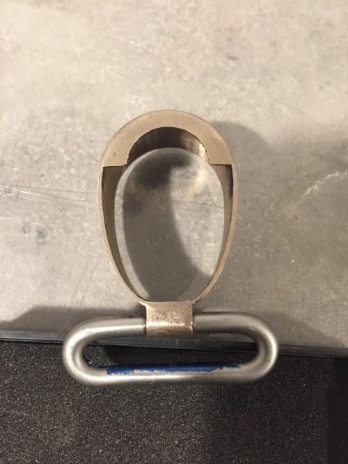

    Here is what it looks like from the factory.

    The MKIII forge style bands can easily be passed off as originals as they are bang on to the originals, actually they are better as they are square! Tell tail sign will be the cross screw as they work but not exact replicas.
    The 3d process of printing also shows tell tail signs. The bayo lug (MkII 3* has a rough appearance, similar to casting. Also, it does not have the rounded feature as stamping provides on the face.
    Had a conversation with one fellow, he asked me why the front is not rounded like the originals. Told him the process on such a thin section (Barrel Hole) won't allow it. I said I wanted it to differentiate from originals having a flat front. But being as close to original as possible.
    I could do the front surface rounded (Below the Hole) and file the angle around the hole if need be. But .....

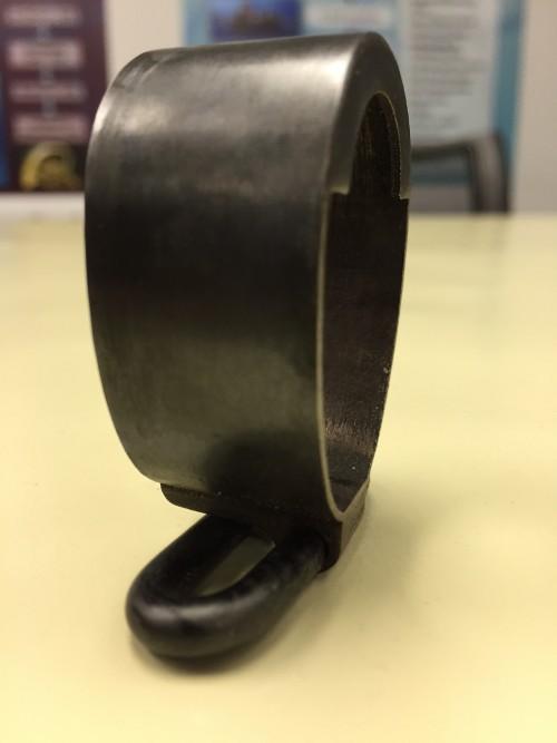

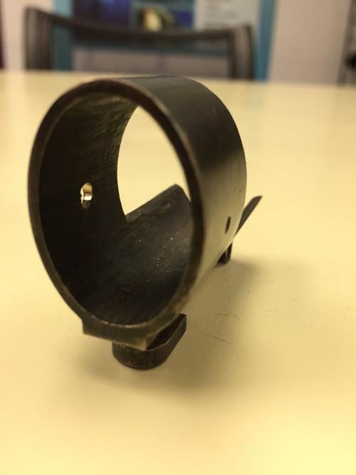

    MKII 3* Band - Profiled
    Mid Bands - Repro

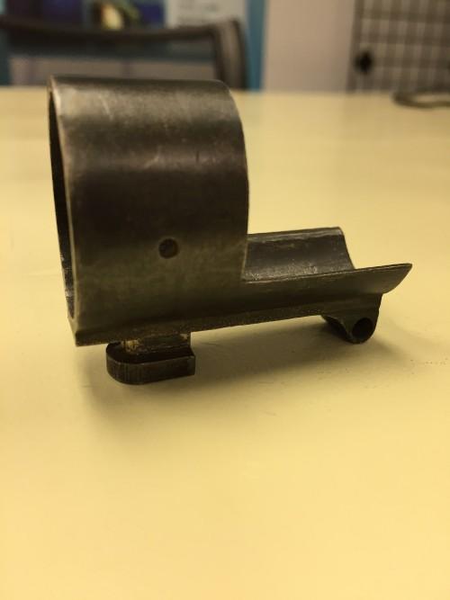

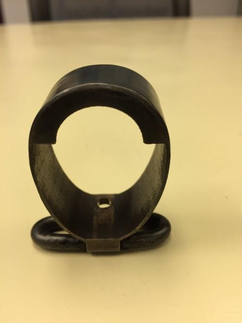

    MKII 1* Band
