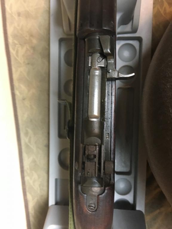

    Pic of gun
    receiver
    top
    barrel Cant see real well in pic Underwood -44 Can not see anything where the month would go
    2
    top front
    2
    2
    trigger
    bayonet lug

    I see the rear sight has been pushed off-center to the left. I have three carbines and every one of them require the windage to be adjusted far left on the sight to obtain correct POI. I wonder if someone was anal enough for this to bug them and pushed the sight over so the elevator could be aligned in the center of the sight? I've not seen as many carbines as most other members here have, but I've not seen a rear sight pushed that far over. This is not a dig....just an observation.

    Quote Originally Posted by flydthecat View Post
    I have an Inland that I aligned the rear sight on. It was way off. Just thought you should have equal windage adjustment in both directions. When the adjustable sights were installed as upgrades, the military manuals showed gauges that were to be used to keep the same windage (with new sight set to the index mark) as the original leaf sight provided . Welcome to the forum! - Bob

    would it be wrong to have the rear adjustable sight off and put the older flip up sight on it? I just like the look better.
