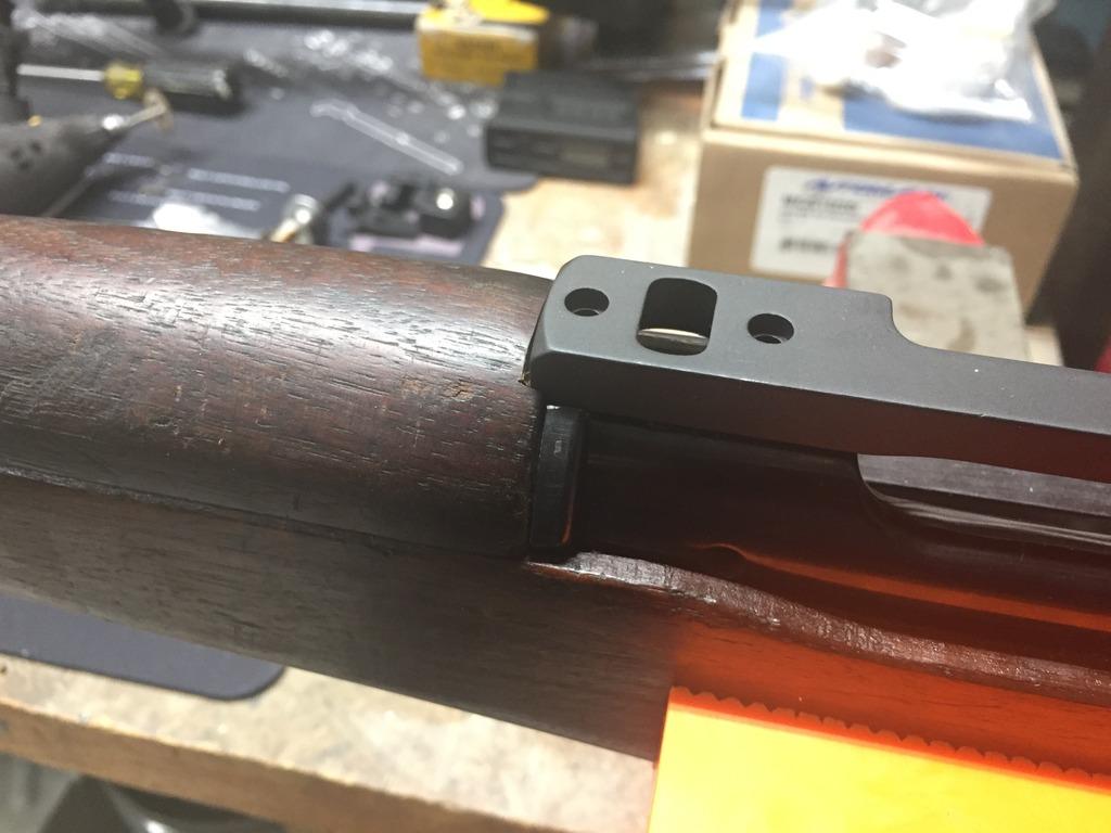

    Ok, so I've made some progress on this project. This was a real learning experience, and I don't know if this was the best way to do this or not but heres what I came up with.
    I ended up cutting a slot through the top of the hand guard ring and I also notched out the top center of the hand guard itself to allow room for the mount. The idea was that there would still be enough of the ring to retain the rear of the hand guard.
    The only other obstacle I ran into was that the lip on the front of the hand guard was too long to slip all the way into the front lug, so I had to trim it down a bit.
