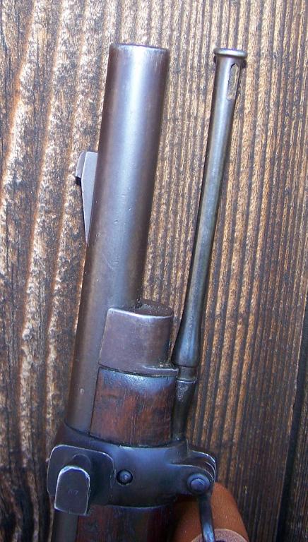

    Can you tell if this is the correct cleaning rod for my MK IV. I'm not sure but I think it is an early type based on the drawings here http://www.martinihenry.com/images4/martinirods.jpg
    If it is correct, is there a way to make it stay in place as it creeps out upon firing. If not I'll start looking for a correct one. IMA seems to be out of them at the moment.
    Apologize for the blurry pic.

    On my MK IV the swivel screw on the upper band tightens up the cleaning rod retention but if taken too far will cause the rod to bow slightly and become impossible to remove. This help? Endless apologies if not. Best wishes. Dave

    I think I have the wrong rod as I don't have that slot like yours at the forestock band.
    Looks like I was wrong about IMA though. The website I looked at this morning had them listed as out of stock, but that must have been someone else as IMA has them for about $30.
    When I get the new one I'll check the swivel screw.

    'flygrimm' - MasterChief's photo shows the correct type of Rod for your Mark IV - MH.
    The Rod you now have is a 'modified' Mark I - MH Rod.
    Originally the Mark I Rod Head was larger. In fact, it was larger than bore diameter and required an implement on the threaded end in order to knock out a stuck case or clean the barrel. IIRC - The 'cross-hole' in the head was for an implement or punch to be inserted to serve as a handle.
    I believe a lot of the 'modified' Mark I - MH Rods have come from the Nepal Cache (of badly stored Britishicon Arms). I don't know if the Heads were ground to smaller diameter in Britain or in Nepal. (Reducing the head diameter allowed the head to enter the bore so the rod could be used to clear a stuck case - Good Move!).
