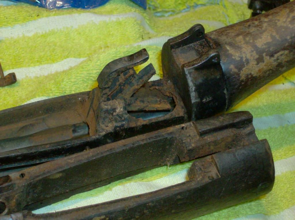

    Hi folks, got a thread started in the "Lee Enfield Knowledge Libraryicon" section but, I figure I should show the progress here in the restoration section.
    After letting Liquid Wrench seep into the screws thread, I carefully worked on them and to my delight, every screw did cooperate.
    These two arsenal repairs on each side of the trigger guard came off but one did not survive (dang)
    Even this came apart easily (ish). Both the screw and the pin came off without excessive force.

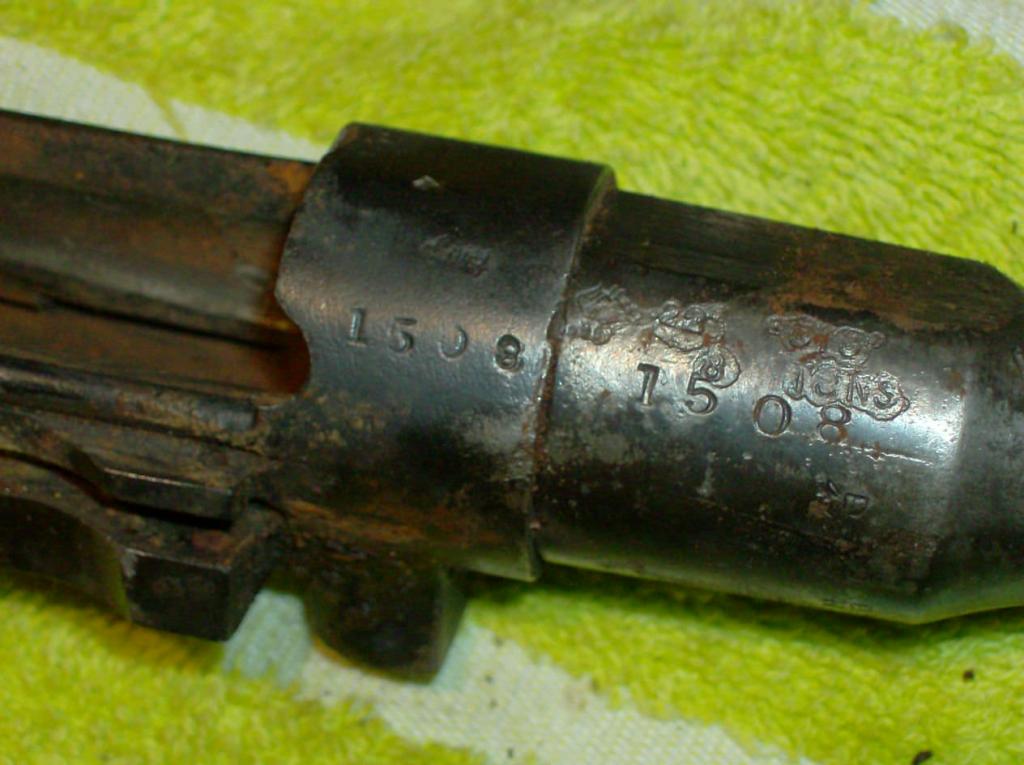

    interestingly the forend is number matched, but stamped inside the barrel channel:
    Not sure about the meaning of this;

    What an excellent prospect for refurbishment! Froom the state of preservation I would guess the rifle was lying in mud rather than water, as mud is very poor in oxygen.
    For a start, I would simply mechanically clean up the metalwork with a brass-wire brush (as used for suede leather). Then use oiled 0000 wirewool on the rougher spots. There could be more original finish left than you think. I would not glass-bead it as such treament will remove any original finish and will not improve the markings.
    Finally, a word of warning. You have seen what happened to the arsenal repair on the stock. Do not apply any of the violent means that have been recommended in the past (drying in an oven, soaking with caustic soda...) The wood must be fairly saturated, and any accelerated drying will cause it to warp or even break up.

    indeed Patrick, that's pretty much the approach I've selected for now. My goal here is minimal intervention to prevent any further damage, and keep as much as the original finish as possible. Remove the mineral or organic deposits on the wood and metal; repair the arsenal repairs on both sides of the trigger guard (I believe one of the two can be reglued, the other one I will replace); do all I can to clean the bore (there seems to be some remnant of rifling), and, reassemble, shoot. I have to say it's going rather well at the moment. The wood is getting cleaned up, will be oiled with pure lnseed soon. (after the repair is done). There are some splits and cracks which need to be reinforced.
